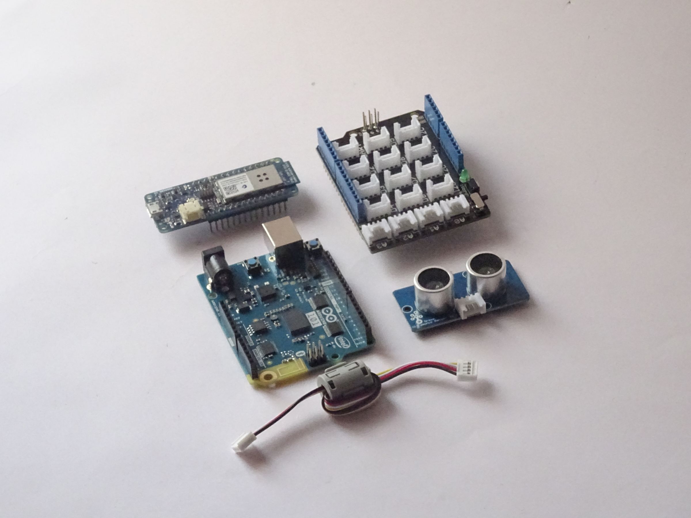

Step 3: MATERIALS NEEDED
Hardware:
- Grover Base Shield v2 - this shield makes it very convenient to connect the sensor module.
- Arduino 101 - the brain of our system.
- 9v Battery ( Gearbest) - these batteries will power the Arduino board
- Plastic Container (Gearbest) - I found an old plastic container in which all the components could fit. The box is important as you can easily access the components and it's waterproof.
- Ultrasonic Sensor (Gearbest) - An ultrasonic sensor measures distance. It will be attached to the lid indicating the quantity of trash. Our system's key component.
- White spray Paint (Amazon) - turns your regular box into a more professional product

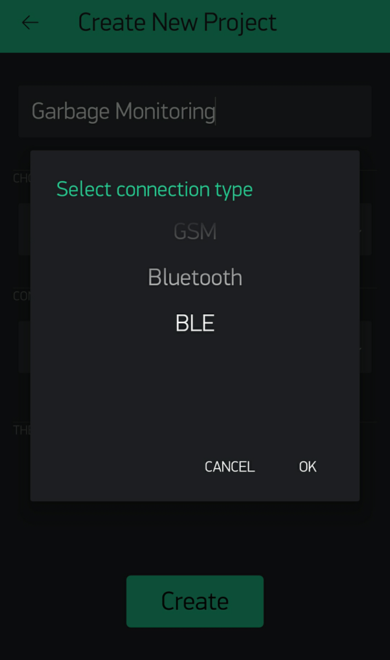

Once you've downloaded and installed the Blynk app on your mobile device, go ahead and open it then create a new project. Start by selecting the micro controller you're using, choose the "Arduino 101". And as connection type choose "BLE (Bluetooth low energy)".
(Follow along using the pictures below)
Once that's done you will be sent a mail to your registered email id containing the "Auth token", theAuth token needs to be copied and replaced into the program (explained in the next step)

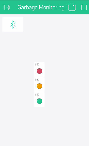

Now click on the "+" icon on the top right of the screen and add three LEDs. The LEDs need to be assigned to virtual pins 0,1 and 2, and the colors of each led could be changed according to your liking, in our case we made the bottom one Green, the one in the center Orange and the top one Red, indicating the level of your trash from low shown with the Green Led lighting up to high being the Red one.
This is how it should finally look like!

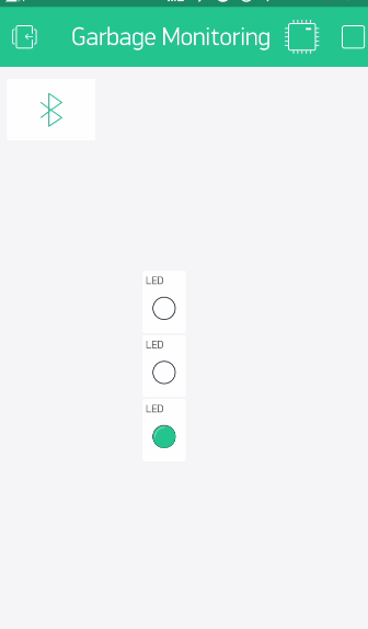

These are screenshots of my phone as I filled the dustbin. On the blynk application, Green ranges from 0 to 25% full, Orange from 25 to 65% and Red from 65 to 100%. Here are the successful results :
After having put 10% of trash and closing the bin we have the green LED that comes on the other two stay off.
50% full...
...and finally we put all the trash possible, and all three LEDs and a smile lit up! Congratulations the model works : )
