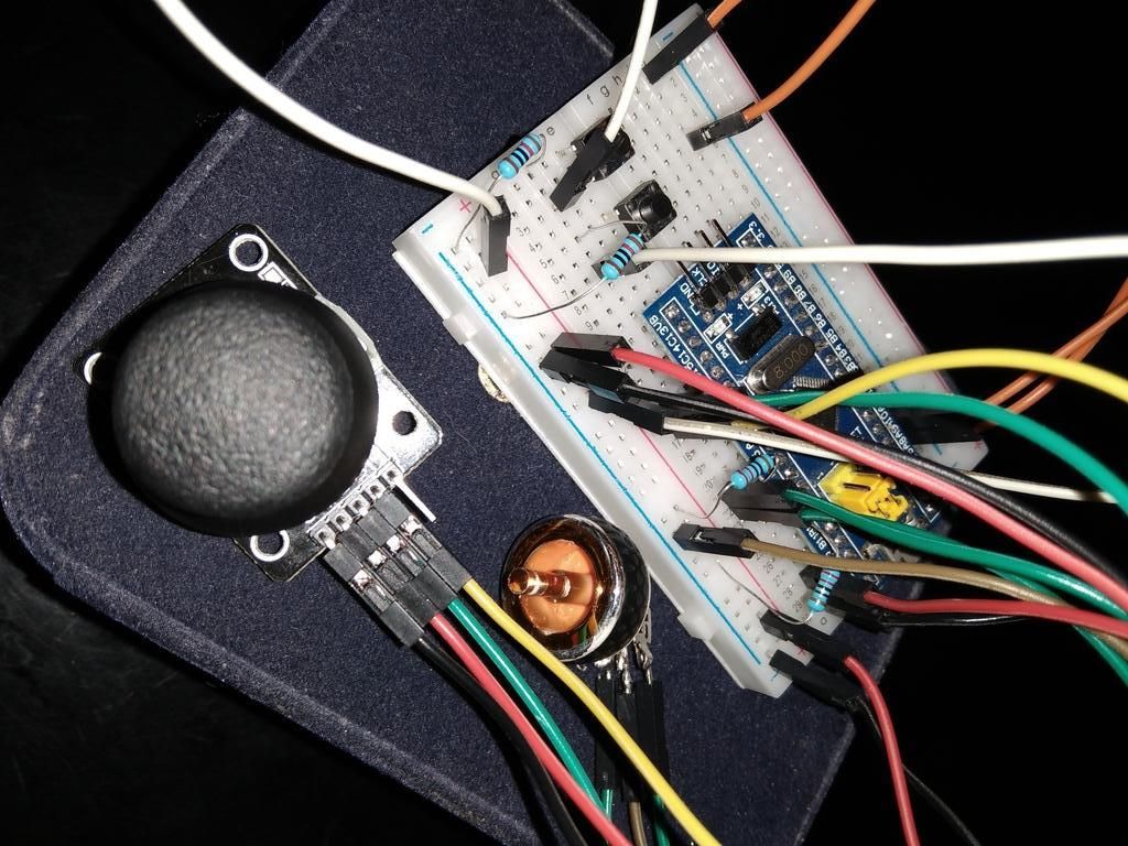

Step 1: Circuit Diagram of the Home Automation Project
  • A4 -> SDA
  • A5 -> SCL
Step 2: Preparing the Components
Connect wires to the Arduino
Carefully follow the wiring configuration table provided which shows the Arduino pin numbers and the associated pin numbers.

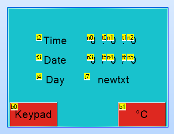

Step 4: Nextion Code
1. Upload and Test the code
Upload the code via Nextion Editor.
(To use Nextion code file, change the .ino to .HMI)
