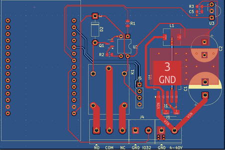

Step 1:
📐 Circuit Design
The PCB connects the ESP32 with the relay driver circuit and IR receiver.
The GPIO for the relay is configured in ESPHome, while another GPIO is available for expansion (sensors, LEDs, etc.).
A buck converter regulates the wide input voltage down to 3V3.

Step 3: 🔧 Assembly
1️⃣ SMD Soldering
Start by soldering the small SMD components first (resistors, capacitors, transistor, etc.).
You can hand-solder with fine tip + flux or use a hot plate/reflow method.
2️⃣ Through-Hole Components
Next, solder:
  1. ESP32 header
  2. Relay
  3. Screw terminals
  4. IR receiver
3️⃣ Final Check
Ensure polarity of capacitors and diode are correct.
Power up via 5 V USB or external 12–48 V supply.
