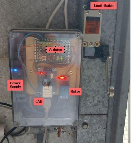

- Garage-Gate Controller (See Instruction "Garage Door Opener Calling by Phone Via Arduino and ASTERISK Behind a FritzBox")

- The yellow LED is on when the garage is open and off when the garage is closed
