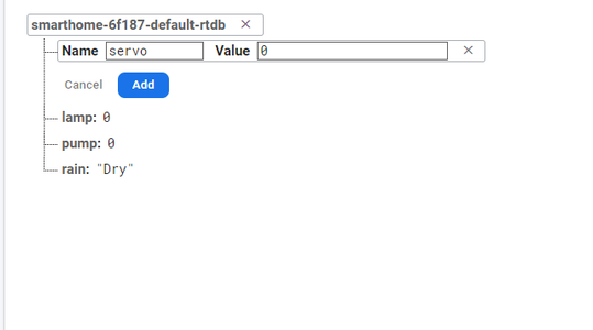

Step 4: Make Database Child
  1. Go back to Data
  2. Click + to add Child
  3. Create 4 Child, named lamp with 0 value, pump with 0 value, servo with 0 value, and rain with “Dry” value

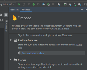

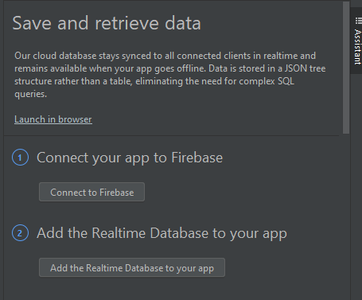

Step 6: Connect Firebase to Android Studio
  1. Go to Tools
  2. Click Firebase
  3. Choose Realtime Database
  4. Connect your app to Firebase
  5. Add the Realtime Database to your app

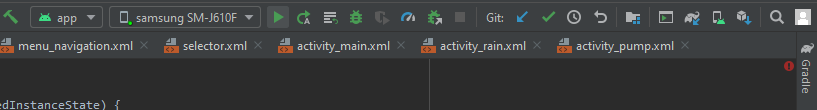

Step 9: Upload to Your Smartphone
  1. Connect Your Phone using USB
  2. Click Run, after your device was detected

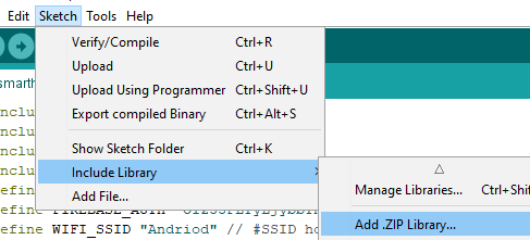

Step 12: ESP8266 Program in Arduino IDE (add New Library)
  1. Download FirebaseESP8266 Library
  2. Click Sketch
  3. Click Include Library
  4. Click Add .ZIP Library
  5. Choose Firebase-ESP8266-master.zip
