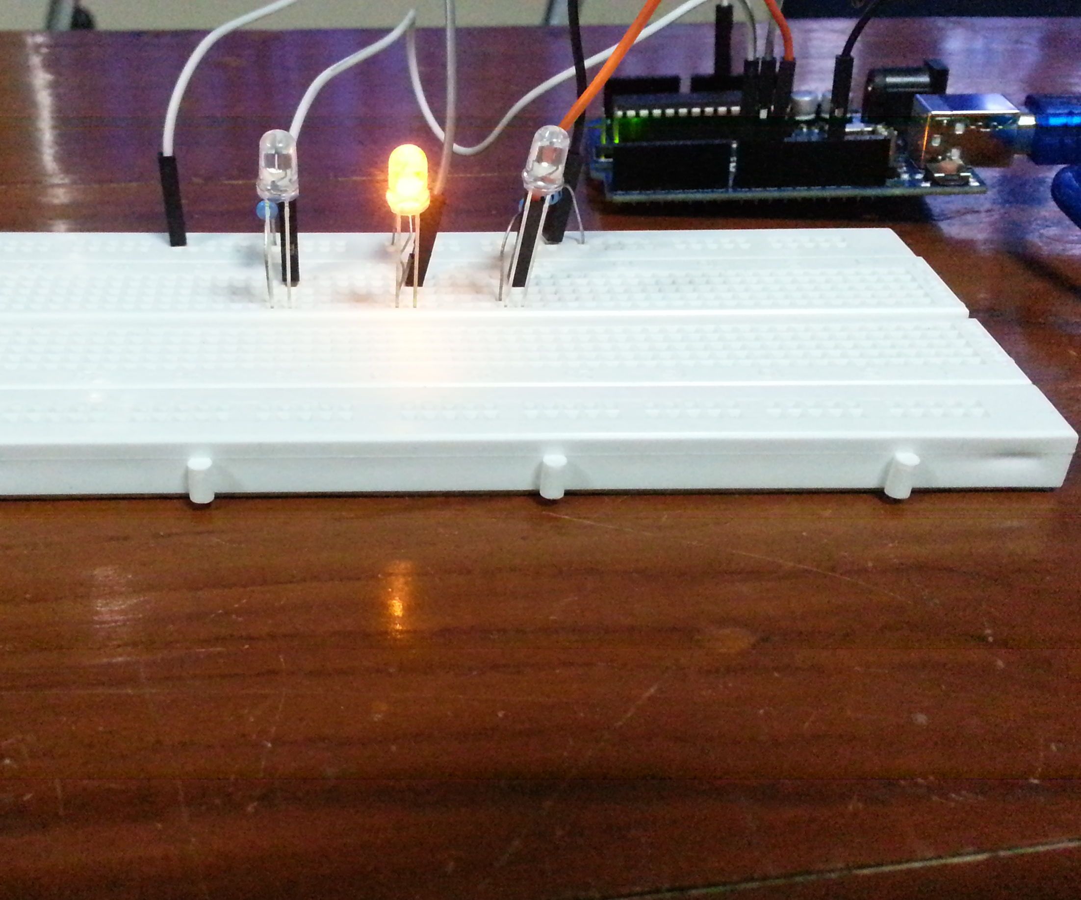

Step 2: Connection
The components that already exist, then connected in order to be integrated each other. This connection is made in Fritzing software. The following is the diagram in picture.
