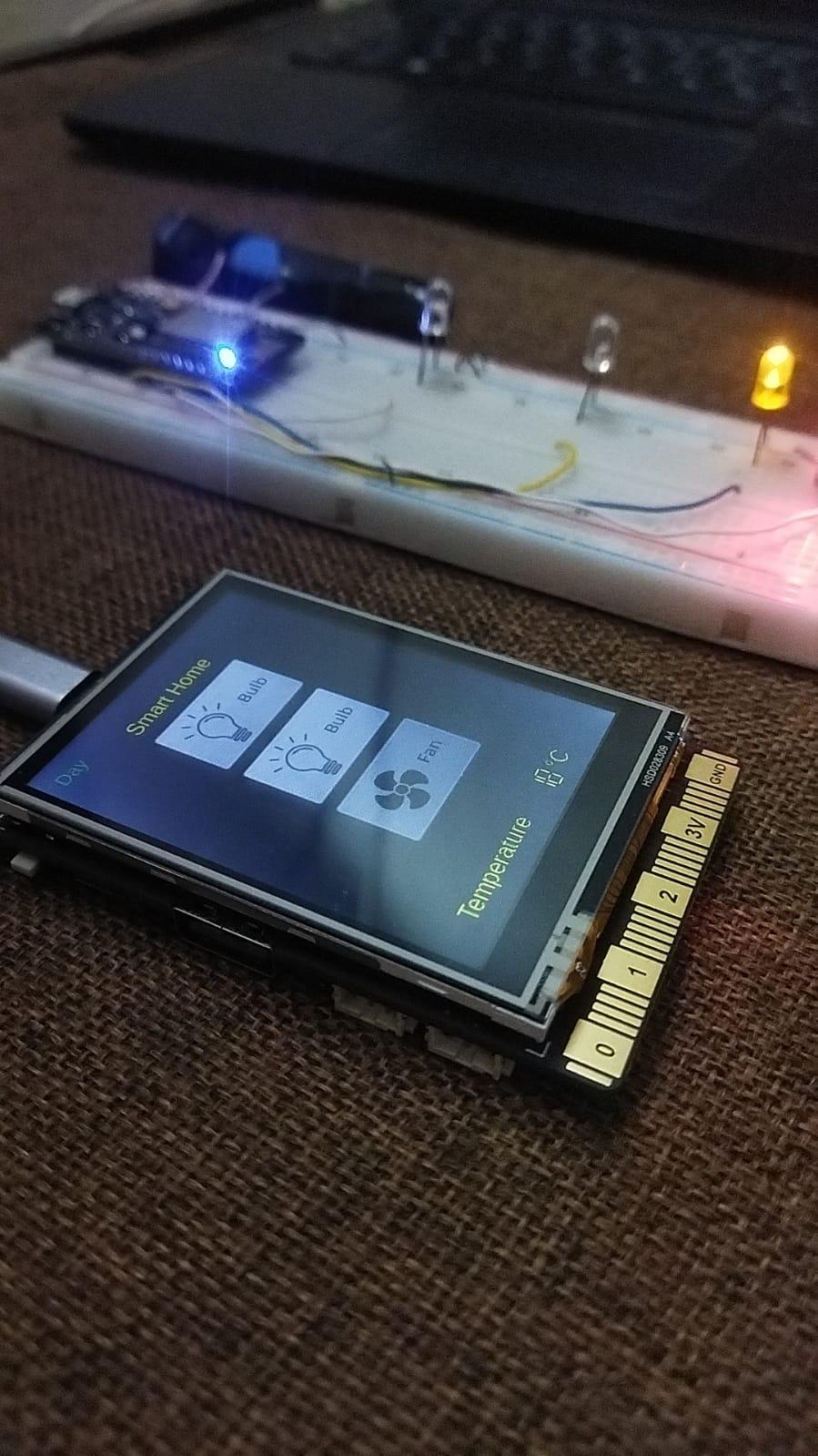

In this project, we'll be harnessing the power of the new Unihiker Single Board Computer (SBC) to create a smart home setup. Imagine controlling lights and monitoring room temperature with just a few clicks - that's the essence of what we're building.
Using Unihiker as our brains, we'll connect three buttons to control three LEDs via Nodemcu using MQTT - a nifty communication protocol. Plus, we'll toss in a DHT11 sensor to keep tabs on the room temperature.
This project serves as a beginner-friendly gateway to the home automation. With straightforward steps and minimal components, you'll be amazed at the magic you can create within your living space. Let's dive in and turn your home a tad smarter!

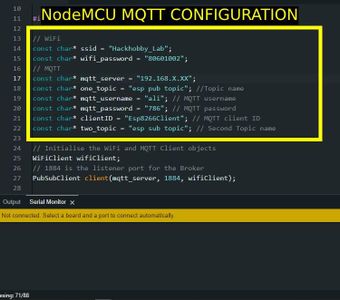

Instructions for NodeMCU MQTT Configuration:
  1. MQTT Broker Configuration:
  2. mqtt_server: Set this variable to the IP address (or hostname) of the MQTT broker you are connecting the NodeMCU to.
  3. Topic Configuration:
  4. one_topic: This is the MQTT topic to which the NodeMCU will publish data. Ensure it matches the topic the Python side is subscribed to for receiving messages.
  5. two_topic: NodeMCU will subscribe to this topic to receive data from the Python side. Verify that this topic aligns with the one Python uses for publishing messages.
  6. MQTT Credentials:
  7. mqtt_username and mqtt_password: Enter the MQTT username and password that match the credentials set in your MQTT broker. Ensure they provide appropriate access rights for communication.
  8. Client ID:
  9. clientID: This is the unique client ID assigned to the NodeMCU for MQTT communication. Ensure it's distinct and identifiable within your MQTT broker environment.

Step 6: Hardware and Wiring
DHT11 Sensor Wiring:
DHTPIN:
Defined as DHTPIN D2 in the code, which means the DHT sensor is connected to digital pin D2 on the NodeMCU.
  • Connect the DHT11 sensor's VCC pin to the NodeMCU's 5V pin.
  • Connect the DHT11 sensor's GND pin to the NodeMCU's GND pin.
  • Connect the DHT11 sensor's DATA pin to digital pin D2 on the NodeMCU.
Output Devices (LEDs in my case):
Defined output pins:
int Out1 = D4; int Out2 = D5; int Out3 = D1;.
  • Connect the positive (anode) terminals of the LEDs to these output pins (D4, D5, D1).
  • Connect the negative (cathode) terminals of the LEDs or the fan to the NodeMCU's GND pin.
And if you are using a 3v cell then Connect it's Positive terminal to the Vin or 5v line, and negative to GND terminal.

First Program the Nodemcu by opening the Arduino code file. Change the credentials as per you want.
And hit Upload.

Step 8: Working
