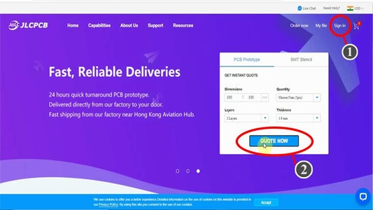

    Step 6: Order the PCB
    After downloading the Garber file you can easily order the PCB
    1. Visit https://jlcpcb.com/RHS and Sign in / Sign up
    2. Click on the QUOTE NOW button.
    3. Click on the "Add your Gerber file" button. Then browse and select the Gerber file you have downloaded.

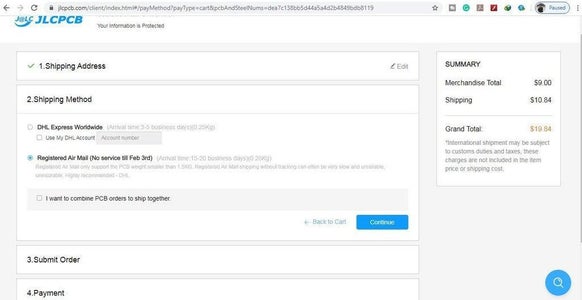

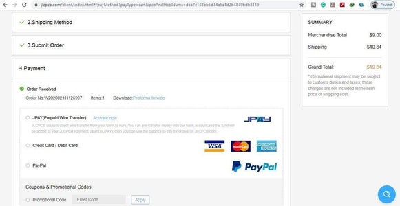

    Step 8: Select Shipping Address and Payment Mode
    6. Type the Shipping Address.
    7. Select the Shipping Method suitable for you.
    8. Submit the order and proceed with the payment.
    You can also track your order from JLCPCB.com. My PCBs took 2 days to get manufactured and arrived within a week using the DHL delivery option.
    PCBs were well packed and the quality was really good at this affordable price.

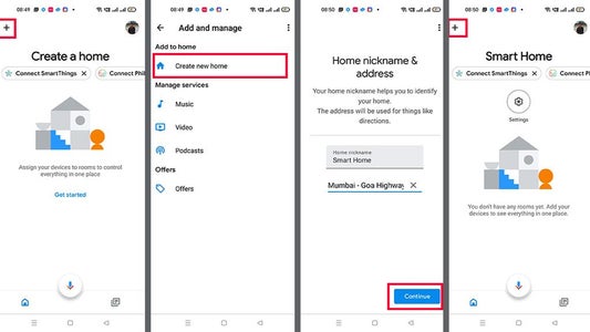

    Step 13: Setup the Google Home App
    First, download and install the Google Home App. then follow the steps to create Home in Google Home app
    1. Tap on the "+" icon (upper left corner).
    2. Tap on Create new home.
    3. Enter the Home nickname and address.
    4. Then click on Continue.
    The Home is created. Now again tap on the "+" icon to add devices.

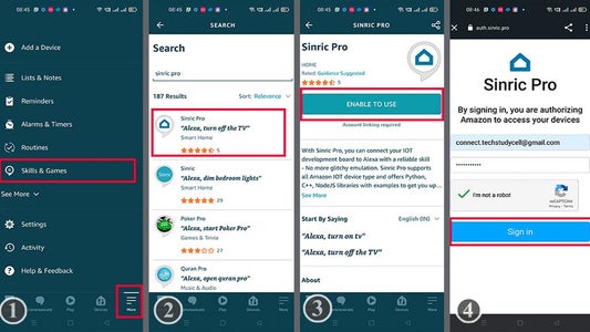

    Step 15: Configure the Alexa App for This Smart Home System
    Download and install the Amazon Alexa App from the Google play store or App Store.
    1. Go to "More", then select "Skills & Games"
    2. Search for Sinric Pro and tap on "Sinric Pro".
    3. Tap on "ENABLE TO USE"
    4. Log in with the Sinric account credentials.
