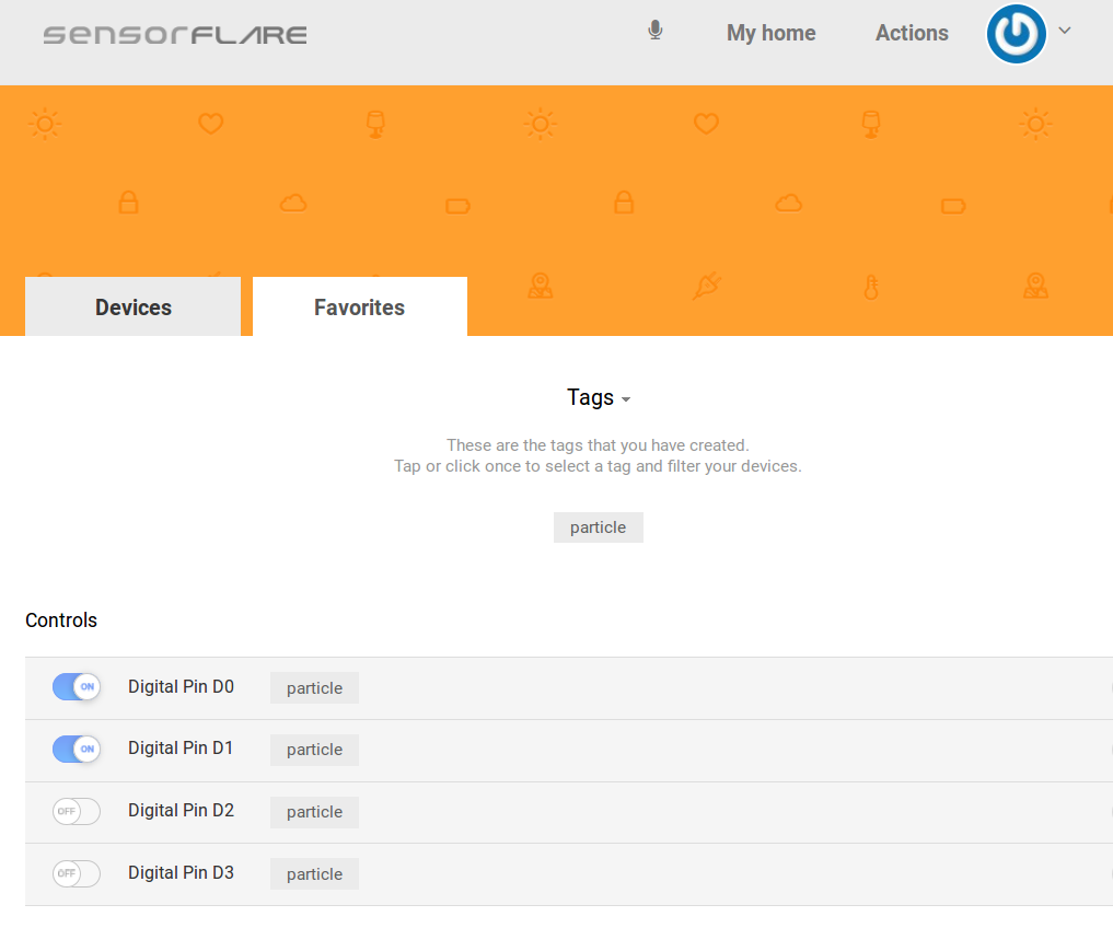

- First you need to connect to Sensorflare and visit the Connected Accounts page to enable communication between Sensorflare and your Particle core.
- Click the "Add new account" button and select Particle option.
Step 9: Include Your API Access Token
- Introduce your API access token that you have found on the Step 5
Step 10: Choose the Specific Core Output Functionalities
- All your Particle devices that has been uploaded to Particle cloud will be listed here. Select the specific one that you want to be remote control with Sensorflare.
- Select the Digital pins that you want switch on/off remotely. Any Digital pin will be controlled remotely on this example.
- Select the output pins in which you have connected an element that will be remotely controlled by a PWM signal. In this example is being selected the A0 pin in which has been connected the Led.
Step 11: Control PWM Switch Using Sensorflare
The brightness of the led will be controlled from your Sensorflare account. Switch on/of your PWM switch and select the "brightness". The parameter "brightness" select the duty cycle of the PWM signal that is created on the A0 PWM output pin in which is connected the led.
Step 12: Observe Your Sensor Values Using Sensorflare
- You can check your sensor values on Sensorflare. The variables that you have been published on your code core will be observed here. The PIR, temperature and light sensor values are available in this example.
- You can select on each sensor for seeing the day values statistics.
