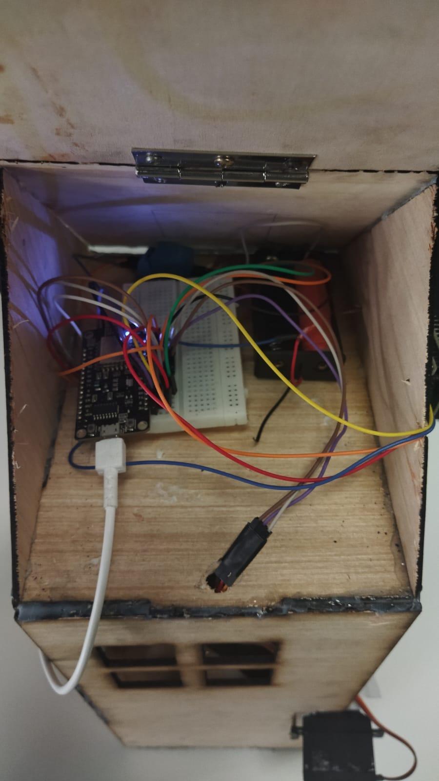

Step 1: Wiring
Now that we have an overview of the components, let's dive into how everything is connected to the ESP8266. Proper wiring is crucial for ensuring smooth communication between the microcontroller and all the devices, so here's a breakdown of the pin connections that bring this smart home system to life:
  1. (D4): Pin connected to the servo motor. The servo will move to different positions based on Blynk commands.
  2. (D8): Pin connected to the relay module, used for controlling a fan. It can turn the fan on or off based on the temperature or manual control from Blynk.
  3. (GPIO0 / D3): Pin connected to the DHT11 temperature and humidity sensor.
  4. RGB LED Pins:
  5. (D5): Pin connected to the red LED of the RGB LED.
  6. (D6): Pin connected to the green LED of the RGB LED.
  7. (D7): Pin connected to the blue LED of the RGB LED.
  8. the LCD is an I2C (Inter-Integrated Circuit) display, meaning it only needs two pins for data communication:
  9. SDA (Data Line): This connects to the D2 (GPIO4) pin on the ESP8266.
  10. SCL (Clock Line): This connects to the D1 (GPIO5) pin on the ESP8266.
Since the LCD uses an I2C backpack, it also has its own address (0x27 in this case) that allows communication over the I2C protocol.
These pins connect various components to the ESP8266 microcontroller and allow control through the Blynk app.

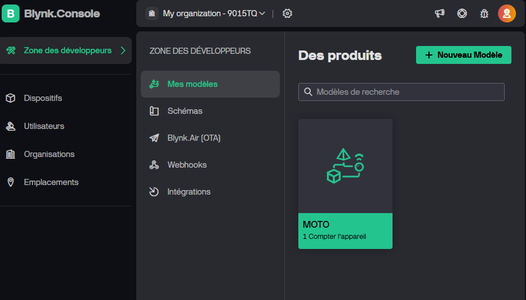

Configuring Blynk on Your Computer
Here, we'll guide you through setting up your Blynk account and configuring devices using the Blynk web interface. Follow these steps to prepare everything on your computer before moving to the smartphone setup.
  1. First, create an account and log in to the system through your computer.
  2. Navigate to the Developers Zone.
  3. Create a new model by setting up the name, material, and type of connection.
  4. A checklist will appear on the screen, showing the steps you need to complete.
  5. Start by creating a data stream and select "Epingle virtuelle."
  6. Fill in all the required information, then click "Create" and save it.
  7. After saving, the new data stream will be displayed.
  8. Next, add a new peripheral by simply providing a name for it.

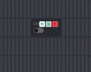

  9. Then, click on "Dashboard Configuration" and select "Modify".
  10. Next, select the widgets you need for your project. Then, go to "More Settings" and add the data stream along with all the required information.
  11. Once all the steps are complete, you can view your control button from "Dispositifs".

Step 4: Building the House
In this part of the project, we designed and constructed the house using wood. The design files were created and then the wooden pieces were cut using a laser cutter, ensuring precision and a smooth fit. Afterward, the pieces were glued together to form the structure. For the curtain, we 3D printed a tube that perfectly fits into our design, and used a piece of cloth to create the actual curtain. We’ll be sharing the design files for these parts as well.
ْْWe also crafted accessories to furnish our home. These included a table, a couch, and even a little car—each piece adding a unique and fun element to the setup.
Step 5: Final Assembly and Project Completion
In this section, we bring all the elements of the project together. After assembling the house, integrating the smart components, and adding our custom-made accessories, we finalize the setup and ensure everything works smoothly. From the carefully crafted wooden pieces to the functional electronics, this is where the vision becomes a reality. Here are some images of the completed project.
