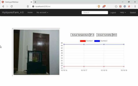

The main idea of this project is Designing a plant pot that provides the plant with what it needs in terms of water (using hydroponic technique), good environment and artificial lighting while having the ability to know what happen around the plant remotely in real time and continuously through a website made by Spring boot and Angular frameworks

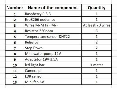

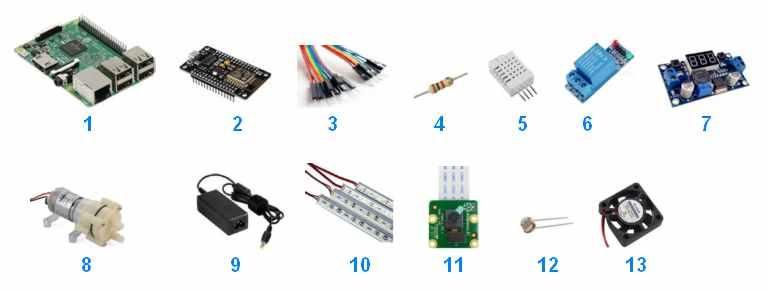

Step 2: Electronic Components
1- Raspeberry Pi3 B: it is a very small computer with an ARM processor that allows the execution of several variants of the free GNU/Linux operating system, including Debian, and compatible software. This board has several models and i have used the Raspberry Pi 3 B model in this project to control the associated electronic components on the plant pot as well as to run the artificial intelligence program.
2- Esp8266 nodemcu : it is a microcontroller with a Wifi connection through which data can be sent and received remotely to Raspberry Pi3. i used this microcontroler to control the associated electronic components (Dht22 / Soil sensor / Led RGB)
3- Wires M/M F/F : Allow to conduct electricity to the desired location.
4- Resistor : are all of a value of 220ohm connected with some electronic components to prevent them from being burned.
5- Temperature sensor DHT22 : Senses the temperature degree that will be displayed automatically on the LCD display.
6- 5V Relay : to help the Raspberry Pi board to turn the mini water pumps on and off.
7- LM2596 DC-DC Module (Step Down) : it is an Adjustable Voltage Regulator Lowerer and thanks to which the Raspbery Pi board and the other components are powered from 19V.
8- mini water pump 12V : pump particularly suitable for the transfer of the liquid food industry like milk, edible oil, drinking water ... etc.
9- Adaptator 19V 3.4A : essential to power the entire electrical circuit of the plant pot
10- Led light bar : to generate artificial light for the plant. There are two colors of light: red and blue.
11- Camera Pi : camera module compatible with the Raspberry Pi with which you can take photos and videos. This camera is essential to analyze the current state of the plant with the help of the artificial intelligence program
12- ldr light sensor: it detects the degree of brightness outside the house. It is thanks to this component that the outdoor leds will turn on when it is dark and turn off when it is light
13- Mini fan 5V : to cool down the place in case of heat

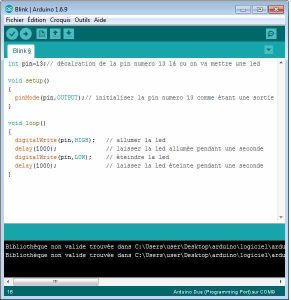

Step 4: Programming the ESP8266 and Raspberry Pi3 B
Once all the electronic components are properly connected to the ESP board, a computer program must be downloaded to ensure proper communication of the system. To create any program, we must first download the programming tool by consulting the following link: www.www.arduino.cc/en/Main/Software, then write the code in C or C++ language.
Here is the code source for who want to do the same

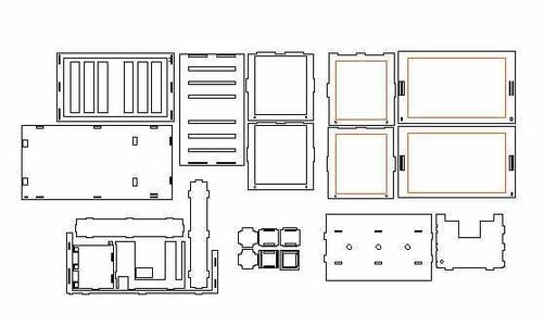

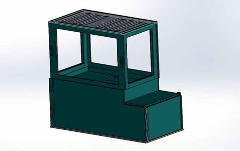

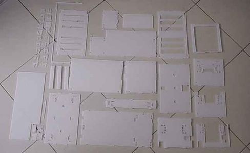

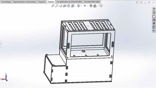

Step 5: Designing and Cutting the Model Using Solidworks and RDWorks
Step 6: Assembling the Wooden Model

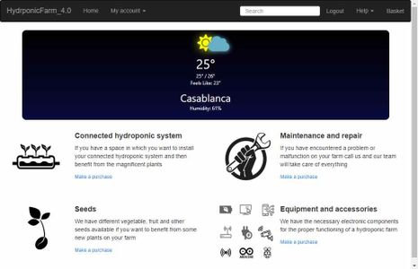

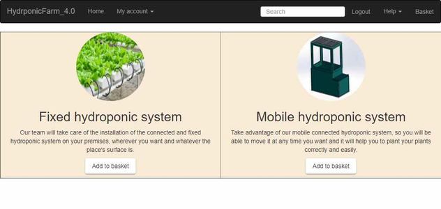

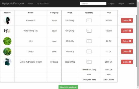

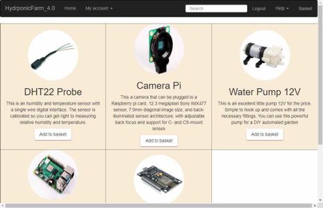

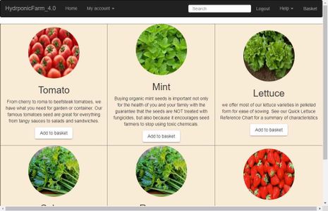

Step 7: Making the Web Site Application
to realize the web application it would be necessary to program the backend and frontend part using the following technologies:
Backend : Spring Boot to follow microservice architecture, Mysql and MongoDB to manage the database and Eclipse as IDE
Frontend : Angular with visual code studio as IDE
For a good development process I used DeveOps techniques with the following tools: Git, Github, Jnekins, Docker and Kubernetes
