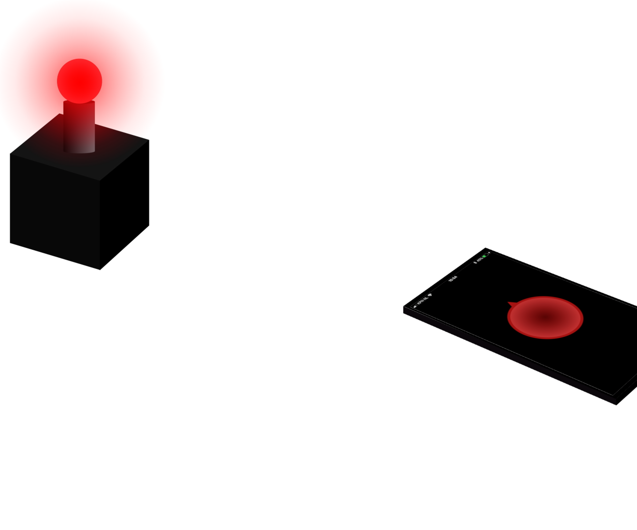

Introduction: Smart Interactive Traffic Light
Ready to build world's best and most interactive traffic light? Good! In this tutorial, we'll explain how you can build one by yourself using Arduino.
