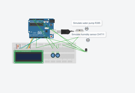

Drip irrigation, sprinkler irrigation, wells, tubewells etc etc. After my geography exam I was fed up with this. So I decided to make my own system which irrigates the plant based on humidity, moisture and temperature. Before building this project at home, I used Tinkercad to simulate the circuit from the comfort of my chair. Thanks to Tinkercad for making such a cool tool! Also here is the link to my project on Tinkercad Circuits

Step 1: Making a New Circuit
Head over to Tinkercad circuits and click on the create new circuit option. Boom! That's it
Step 2: Adding Components and Coding
Well here, from the right section, add the component you want, and connect it however you want. If you want, you can follow the diagram given by me or make your own wiring. After that head over to the code section and paste this

After this you should be good to go and ready to run your first simulation.
Step 3: Running It
Now all you have to do is click the start simulation button, note the errors(There shouldn't be any if you have followed what I have done) and enjoy the output. Now we can work on making this into a real life project, which should be easy enough given that we made a digital replica
