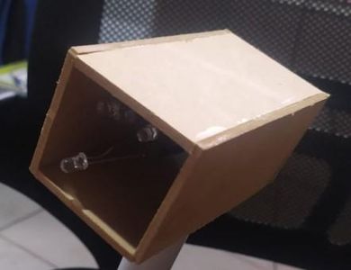

Step 2: LAMP HEAD
For this step you must mark with the pen and the rule the following measures in the fibrofacil.
Cut this with the saw.
Once cut you must make the holes in the down part, then stick all the parts on the base with the carpenter's glue and hold it with the paper tape.
When we finish it the head and the base can fit through the tube.

Solder the ends of the newly made wires to the LEDs.
