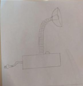

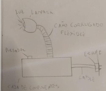

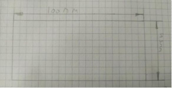

Step 1: SKETCHES
First, we have to start planning what the lamp will be.
Step 2: SKETCH
Once the above is done, we must plan how the model will really be

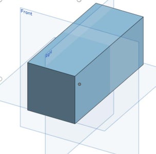

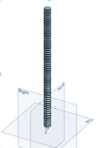

Step 3: MODELING 3D
This in order to know how it will really be.

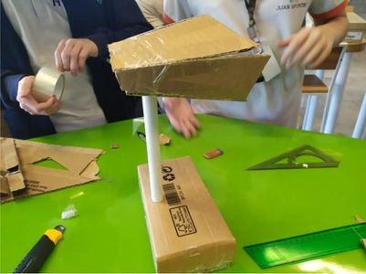

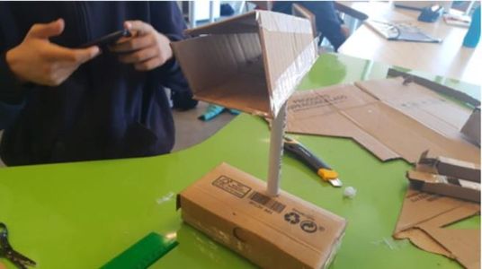

Step 6: RAPID PROTOTYPE
To give us an idea of the size it will have when doing it

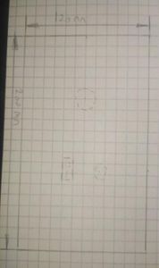

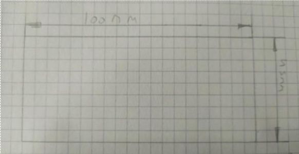

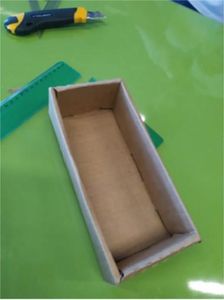

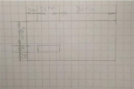

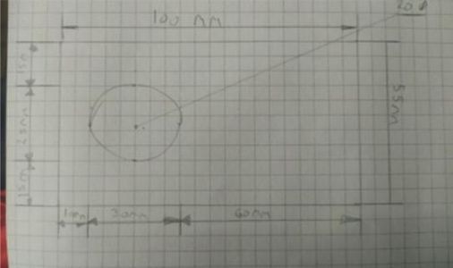

Step 7: LAMP BASE
We are going to start by the lamp base.

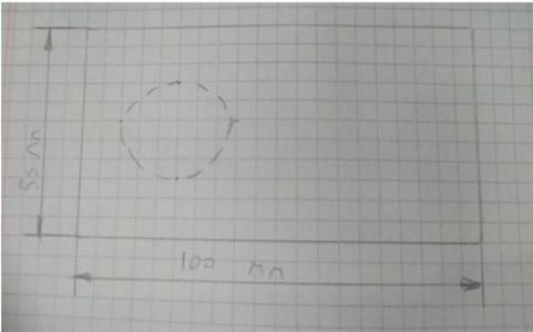

To do it we have to mark with the pen and the rule the following measures in the fibrofacil.
Cut this with the saw.
Once cut you must make the holes on the top and front, then stick the front and back on the base with the carpenter's glue and hold it with the paper tape.
Once glued, remove the paper tape and glue the side parts, not on the base, on the side.
When this is done, the upper part fits exactly into the base and we will have finished it.

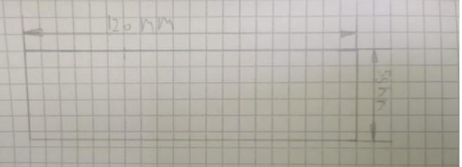

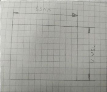

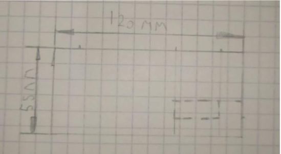

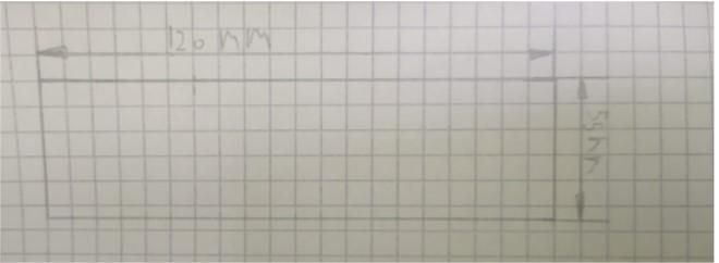

Step 8: LAMP HEAD
For this step you must mark with the pen and the rule the following measures in the fibrofacil.
Once cut you must make the holes in the down part, then stick all the parts on the base with the carpenter's glue and hold it with the paper tape.
When we finish it the head and the base can fit through the tube.

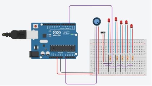

Step 10: CIRCUIT
Join the circuit as follows:
Leave the switch for the end.

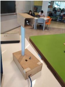

Step 11: FINAL ARMED
Delicately insert the circuit to the base box, pass the Arduino cable through the hole in the front part, pass the long cables through the tube already inserted to the top of the box, assemble the switch, close the box and put head over the tube and secure the potentiometer with the paper tape under the lid.
