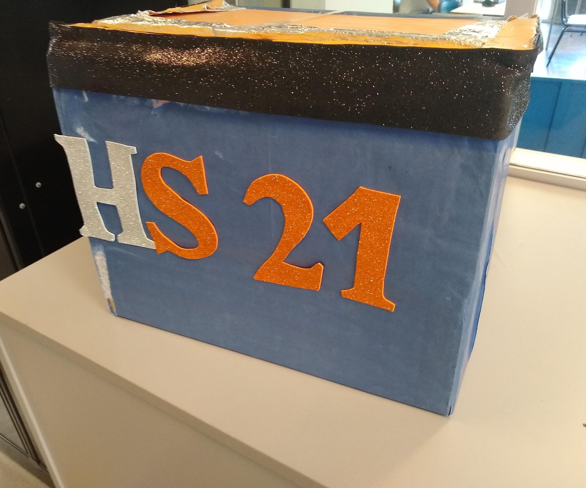

Step 9: Functional Prototype
In this step we made a functional prototype made out of cardboard which could verify that the final product would work, we made this using the manufacturing plans made in the previous step.
About this step maybe cardboard wasn't the best material, so we are planning to re-make this prototype with a better material.
