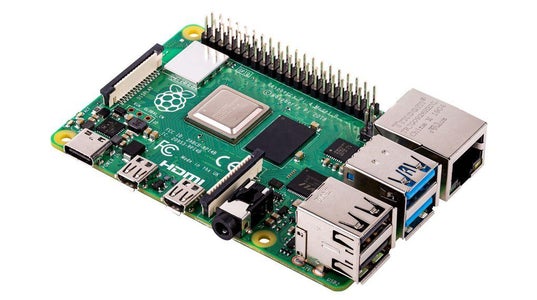

  • Raspberry Pi (3B+/4B 4GB)

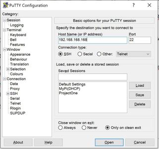

  • Make in Putty a first SSH-connection with the PI to get access to it
