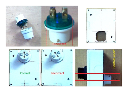

Step 3: Fixing the Adapters
  • Open the adapter and measure the diameter of the threaded portion
  • On the bottom of enclosure, draw a square whose length of a side is equal to the diameter measured.
  • Limit the corner parts of the square and cut away to insert the adapter.
  • The adapter must be placed such that, the contact pins are in parallel with the wall of the enclosure. Use instant sticking glue to fix it (if necessary)
  • Similary, fix the holder on the top of the enclosure.
  • Make sure that, the connecting terminals of the holder and adapter are not in contact.
  • It is better to place them apart as shown.
