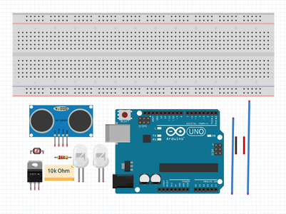

Step 2: Electric Circuit
As you can see, the picture above is the electric circuit of this model. A distance sensor has 4 pins: VCC, TRIG, ECHO en GND. You connect the VCC with the 5V pin of the Arduino board, GND with GND, TRIG and ECHO with 2 of the digital ports, except port 0 and 1 (these ports are only for exchanging data between Arduino and/or the computer).
This MOSFET has 3 pins: GATE, DRAIN and SOURCE (from left to right). You connect the GATE with a PWM pin, DRAIN with the cathode of your LED and the SOURCE with the ground. If you are using a P-channel MOSFET, you have to change the DRAIN and the SOURCE from their place.
