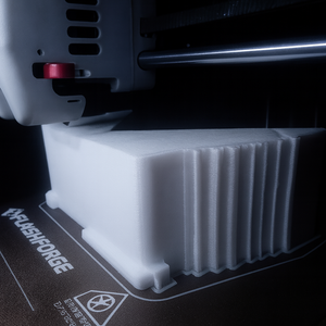

Step 6: 3D Printing the Casing
Please download all of the .STL files that I added in the Supporting Files section and place them into your slicer tool, such as Orca or FlashPrint. For this, I would recommend Orca because you can customize the infill of the file, meaning you can set it to 100% in regions around the screw areas and lower elsewhere. I would not recommend setting it to 100% everywhere since this makes the module extremely heavy.
Check out the image where I configured this in Orca.
After the print is completed, remember to remove any supports.
