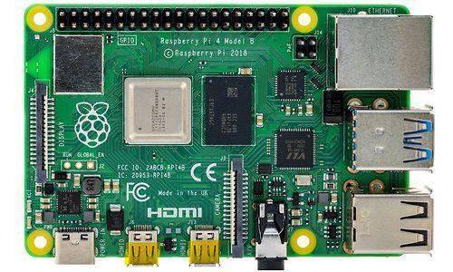

  1. Raspberry Pi (4 model B 2GB used)

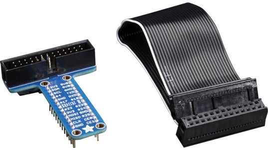

  5. RPi T-Cobbler

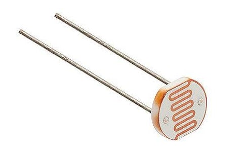

  7. LDR

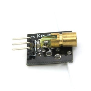

  8. Laser Emitter

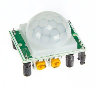

  9. PIR Motion Sensor

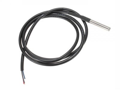

  10. One Wire Temperature Sensor

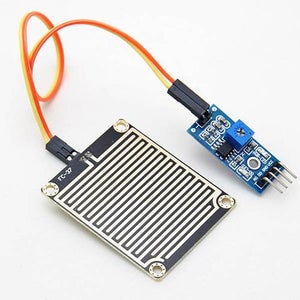

  11. Raindrop Sensor

First things first, let's create the circuit. Make sure the 5V components(LCD, PIR & Servo) are connected to the 5V and the 3.3V components to the 3.3V

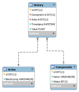

Step 2: Database
Step 2 is the database. I created a simple database that will save the history.
Step 3: Raspberry Pi
To get the RPi to work, you'll need to write an image on the SD Card, I use win32diskimager.
The image I used "Raspberry Pi OS with desktop".

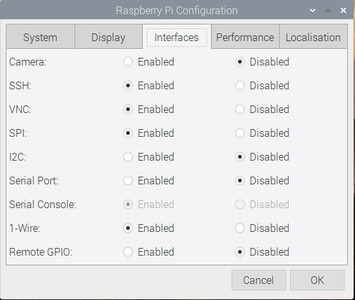

Connect to the Pi via SSH or VNC and turn the right interfaces on.
The only interfaces we need are the SPI and One wire. Make sure to turn the others off because we are using their GPIO pins. SSH & VNC can stay turned on.
