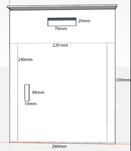

Step 2: Designing the Mailbox
Overall Dimensions:
  1. Height: 33 cm
  2. Width: 16 cm
Mailbox Door:
  1. Height: 24 cm
  2. Width: 22 cm
  3. This is the front-facing door that opens and closes using a servo motor, allowing you to collect your mail.
LCD Display Opening:
  1. Positioned on the front of the mailbox, there’s a cut-out for the LCD screen:
  2. Height: 2 cm
  3. Width: 7 cm
  4. This displays real-time information such as IP address and badge names.

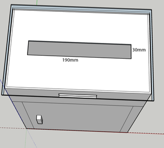

Top Mail Slot:
  1. Located under a hinged flap at the top of the mailbox.
  2. Mail can be inserted through this slot.
  3. Slot size:
  4. Height: 3 cm
  5. Width: 19 cm
False Floor Compartment:
  1. Inside the mailbox is a false floor that hides all electronics neatly underneath. This keeps the sensors, Raspberry Pi, wiring, and components protected and organized, while leaving space above for incoming mail.
