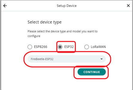

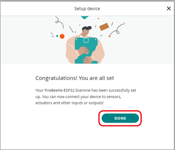

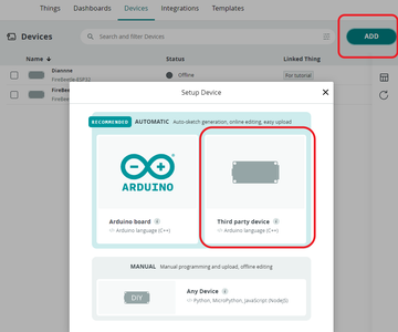

  1. at Arduino Cloud Home page click IOT Cloud botton and add device first.

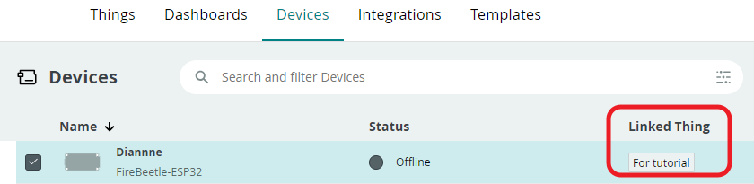

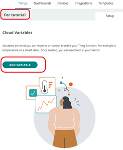

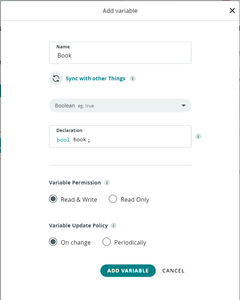

  2. Link device and Thing, add book.

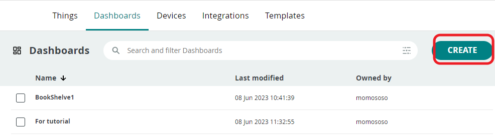

  3. Make dashboard and link to Things.

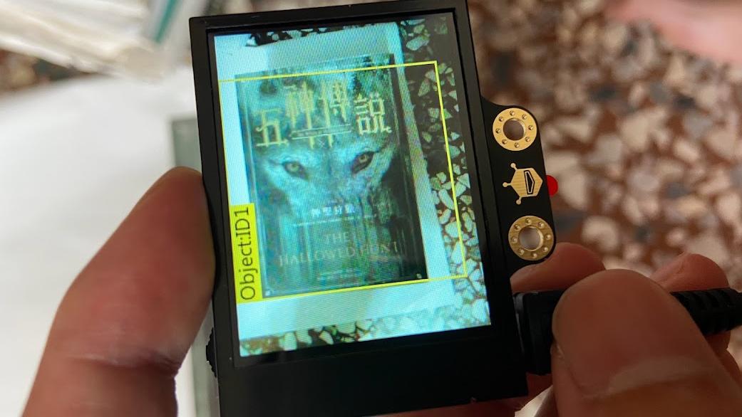

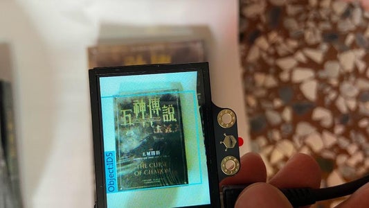

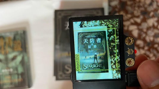

Step 3: Book Classification
Using HUSKYLENS Object Classification function to classify books.
