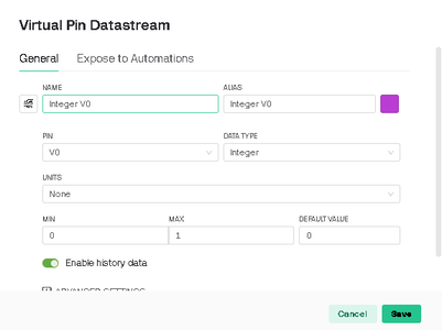

Step 3: Blynk Dashboard Setup
Install the Blynk IoT App on your smartphone.
Create a new project and select ESP8266 as the device.
Add a LED Widget:
  1. Pin: V1
  2. Color: Any
Create an Automation:
  1. Trigger: When V1 (LED widget) is ON
  2. Action: Send a Notification
Copy the Auth Token and paste it into the Arduino code.

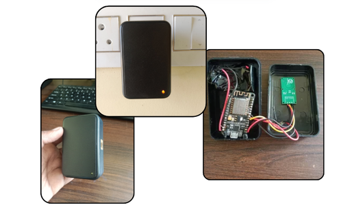

Step 5: Building the Hardware
Blynk IoT https://blynk.io/
If you're a beginner then you might get confused
so, I would suggest watching my YouTube video
https://youtu.be/LwFUjJAT_88
Step 6: Final Working/Output
When some is walking near this(360 degrees and upto max 7meters distance) device then this device will send a notification to the mobile phone
