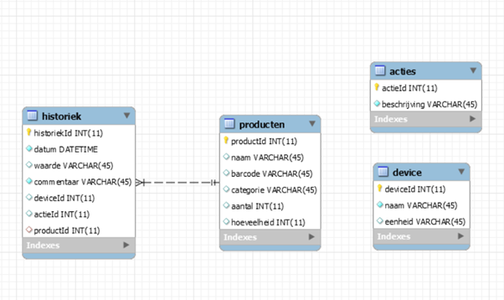

Step 3: Database
To log and store sensordata I have designed my own database. I first made the EER diagram that you can see here.
1. Devices
This table contains all my sensors and actuators. It describes the devicename and the measuring unit.
2. Actions
This table contains all the possible actions. Every id has a description with the action in it.
3. Products
This table contains all the possible products that can be scanned into the fridge. It described the name, category, barcode and quantity.
4. History
This table contains all the sensor logs. Each log has an id, deviceId, actionId, productId, data, value and a comment with the description.
