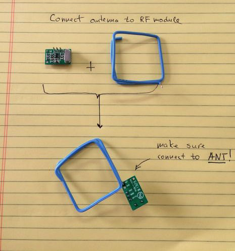

The connectivity of your Raspberry Pi allows you to create easily your own smart office which can be used to connect the switches easily. To do that we need to connect an RF (radio frequency) antenna to your Raspberry Pi, configure it then pair it to RF sockets. You can solder and make the antenna very easily in a minute.

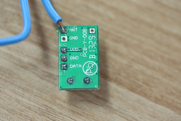

You need to solder the RF transceiver and self-made antenna together. Make sure the soldering connects the antenna to the ANT port on the RF transceiver.
You can have more information on how to make an external antenna in this article.
Keep in mind that the required length of your antenna will depend on the frequency of your RF socket. Our OS supports 433, 477 and 315 MHZ.

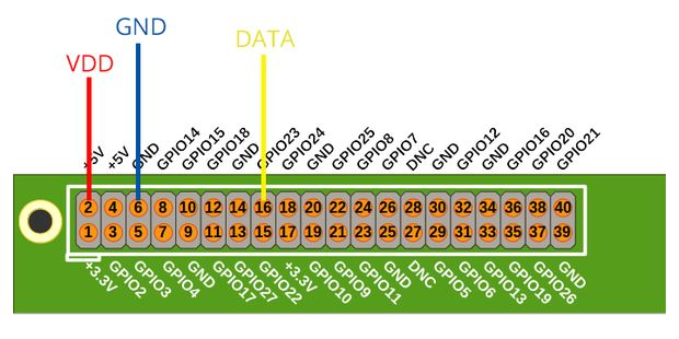

Once soldering is done, plug three jumper wires to your RF transceiver (433/477/315 MHZ).
VDD = Electric current (5V)
GND = ground (select a ground PIN)
DATA = has to be connected to GPIO23
You can connect those three jumper wires as we did on PIN 2 (5V), PIN 6 (GND) and PIN 16 (GPIO 23).

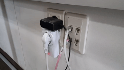

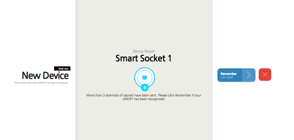

The last step is to connect the configured antenna with the RF socket.

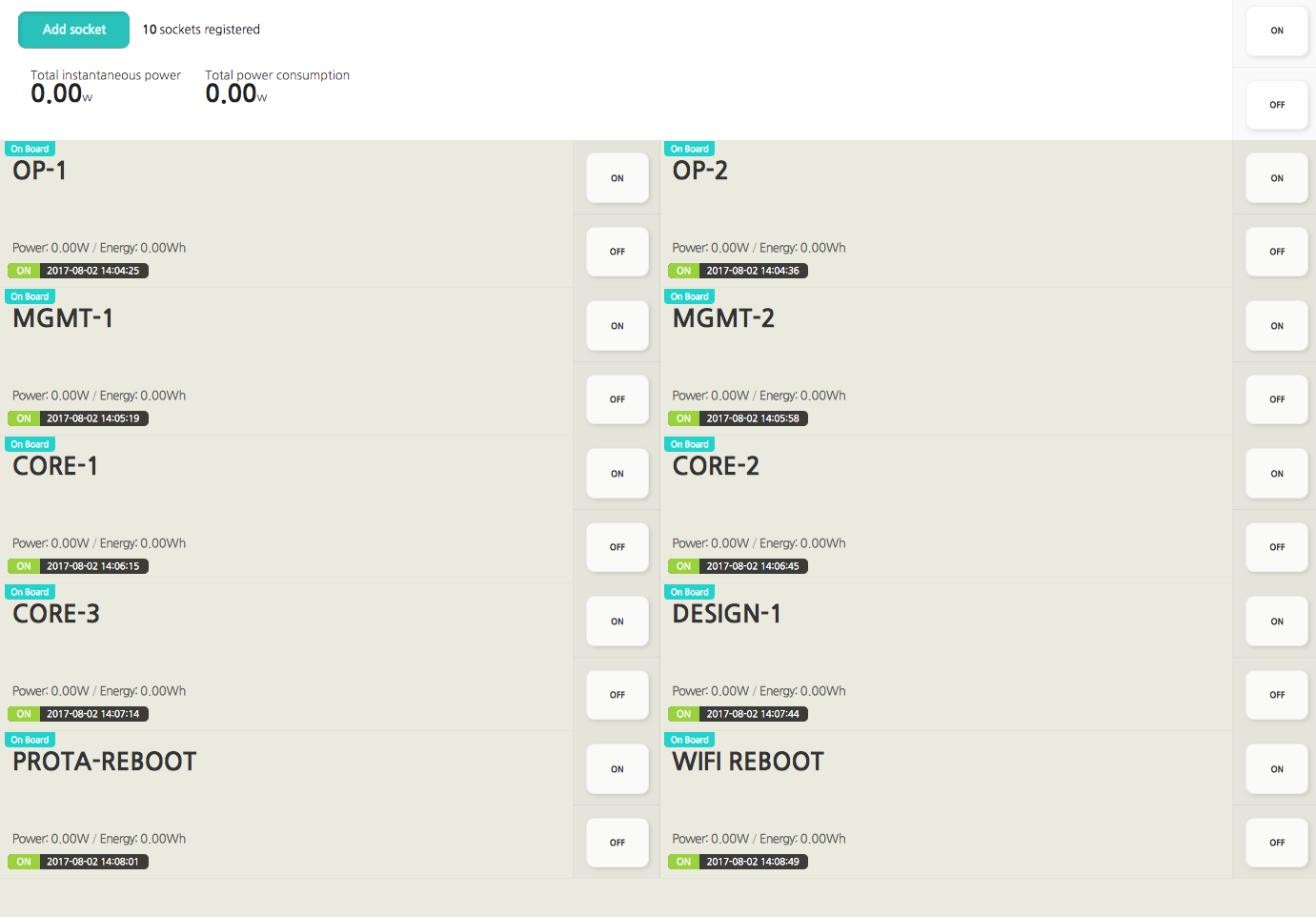

- Open App Libraries and download ON/OFF app
- Click on “Add socket”
- Type-in the details, select “On Board” and click on “Done"
- The app will start scanning the surrounding sockets. Press and hold on the socket’s button until the LED blinks.
- When the LED stops blinking and stay on solid red, it means your Prota Pi has paired with your socket. You can then press on “Remember”.
You can now try turning it on and off via the app interface.

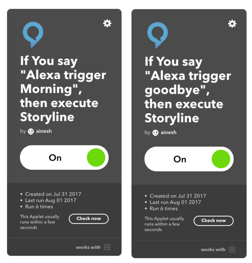

- Create your account on IFTTT
- Search for the channel “Prota”
- Click on “Connect” and select your Prota (you need to use a device which has been granted a Prota Space access)
- Search for “Alexa”
- Click on “Connect” and identify with the account linked to your Amazon account.
- Select New applet and the click “this”- Choose “say a specific phrase” in Amazon Alexa
- Use whatever phrase you want to use and click “Create trigger”
- Click on “+that”
- Choose “Execute Storyline” in Prota and then choose the story which you set earlier from “Which storyline”.
- Click “Create action” and it's done.
You can create other applets as well in a similar way. Alternatively, if you’re using Google home, then you can create a similar applet for Google home usage as well.
