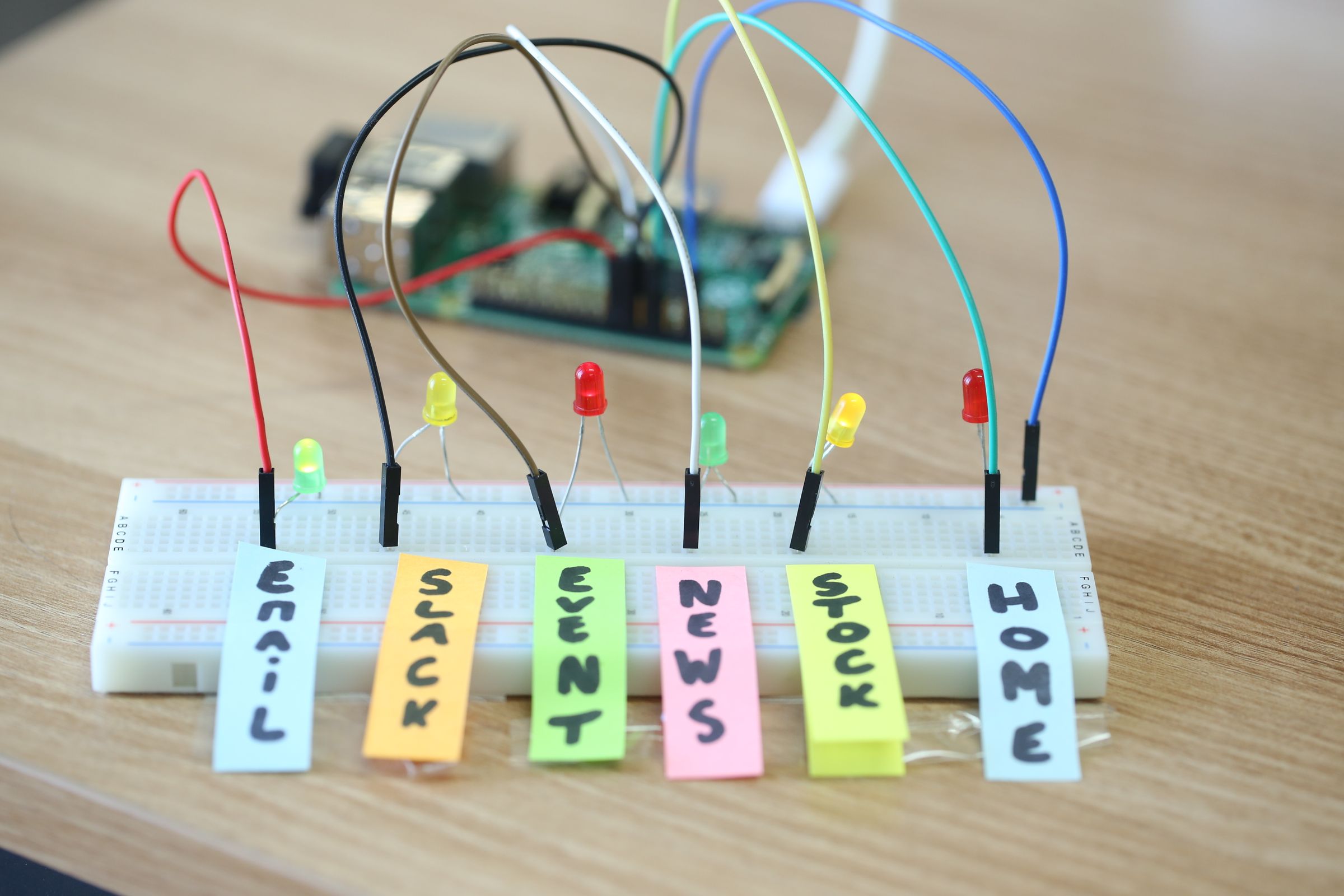

Step 3: SET UP AND CONNECT YOUR GPIO BREADBOARD
The number of LEDs and jumper wires and the size of your breadboard will depend on how many types of notifications and how many connected devices/services you want to have.
In our example, we will choose to have 6 types of LEDs to keep things clear. We chose three different colors of LED (red/yellow/green), but you can of course find many different ones (100 LEDs packs are around $2 on websites like Aliexpress).
Each LED has a short and a long leg. The shorter leg needs to be integrated in the ground (blue) ligne of your breadboard while the longer will have to be connected to a GPIO pin providing necessary voltage. Connect each LED as in the pictures below.

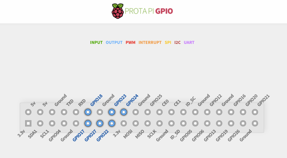

Now add the jumper wires. One has to connect the ground ligne of the breadboard with a ground pin (we chose PIN06). All other jumper wires need to connect the voltage leg of the LED to a GPIO pin (we chose GPIO 17/27/22/18/23/24). Remember the order, as you will need it for the automation workflows. You can set it up as below.

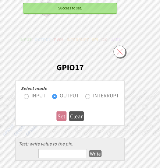

Now it’s time to set the link between Prota OS and the GPIO breadboard.
- Download the GPIO app in App Libraries
- Open GPIO Click on GPIO17 and select “Output”.
- This will make your LED responsive to an output state of either 1 or 0 (1 = on / 0 = off).
- You can test the connection by typing 1 and 0 in the test box below to see if turns on and off your LED
- Repeat the same for GPIO 27, 22, 18, 23 and 24

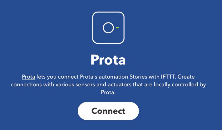

IFTTT
- Download the IFTTT app from App Libraries (in Prota Space)
- From the same device you use Prota Space (smartphone or desktop browser), access IFTTT.com and sign-in/sign-up
- Search for “Prota” and click on connect. Select your Prota to connect it to your IFTTT account.
- Search for Google Calendar, NY Times and Stock to connect to those services.

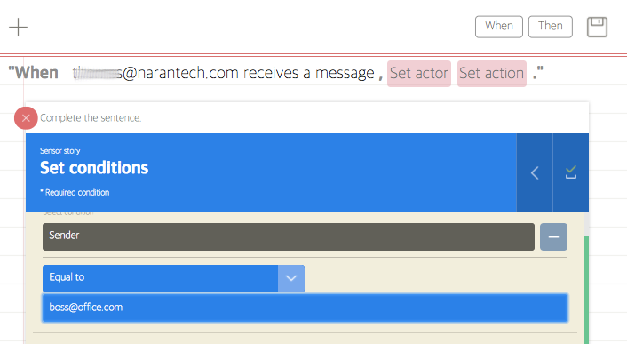

LED 1
- Open Stories app

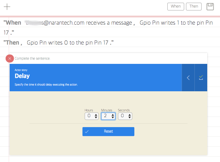

- Write the following Storyline:“When I receive a message from “boss@office.com”, GPIO write value 1 to PIN 17
- Click on “Then” and add the action that will turn off the LED “GPIO write value 0 to PIN 17”.
- Click on Extra Options and add a delay of 2 minutes. That way the LED will automatically turn off after two minutes.
- You can write several similar storyline to add more conditions to what is considered as important email, for instance several different email address or if an email contains a specific subject line

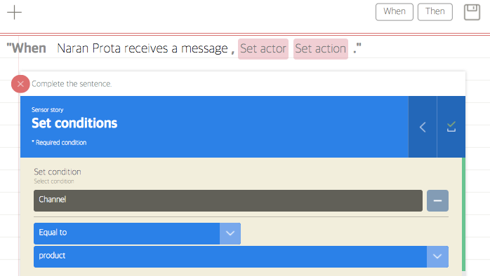

LED 2
The concept is the same as before. For the Event-story, you should select your Slack account and decide that the trigger will be either a message in a specific channel or from a specific user.
You can as well create several storylines for each type of message considered as important on Slack.

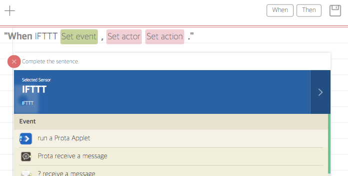

When linking a storyline to an IFTTT applet, you need to write the event as below
Now add the action as explained for LED 1.

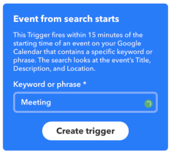

It’s now necessary to create the IFTTT applet that will trigger this Prota storyline.
- Select Google Calendar as trigger. You can either choose any event as a trigger or specific ones (here the ones including with “meeting”)
- Select Prota as action and select the storyline you just wrote.
- Save

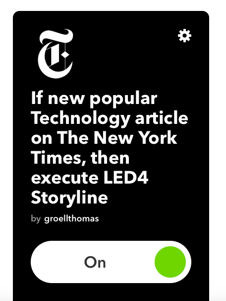

LED 4
Follow the same process, with an applet including The New York Times as a trigger. You can choose to be alerted of articles in a specific section or related to specific keywords.

Step 6: INSTALLATION
Now for the final touch, you only need to paste your tiny sticky notes with written details of what each LED is linked to, so that your can now use your breadboard as your notification center to better assist you on your daily tasks and let you focus more on what matters.
