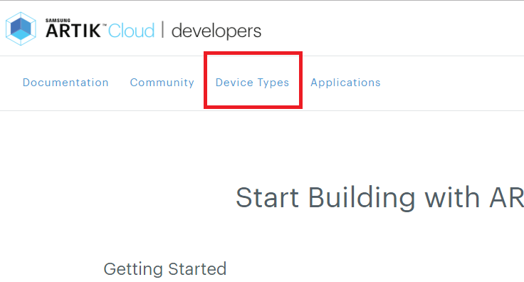

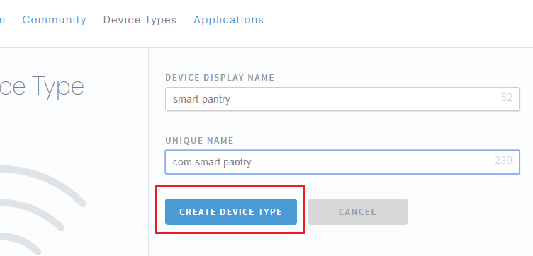

First you have to create a new Device type in Artik Cloud server. To do so follow the steps
1. Click on Device Types
2. Give a device display name (smart-pantry in my case), unique name (com.smart.pantry) and then click on CREATE DEVICE TYPE

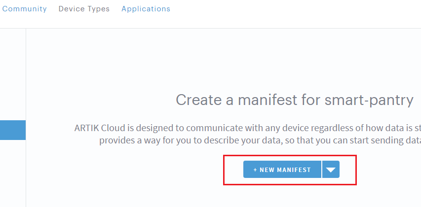

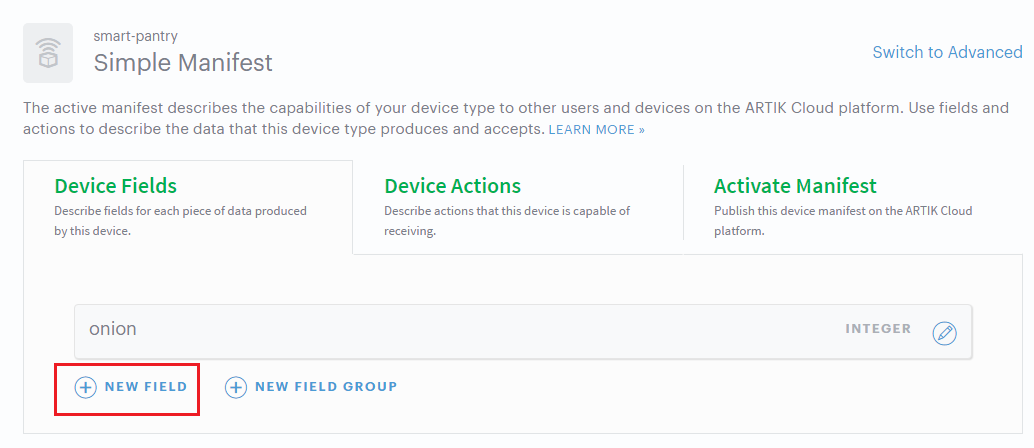

3. Then, click on NEW MANIFEST
4. Give a field name (the data field or variable for your data received from raspberry pi), select a data type and unit of measurement. Now, click on SAVE
5. Click on NEW FIELD and add as many field as your requirement

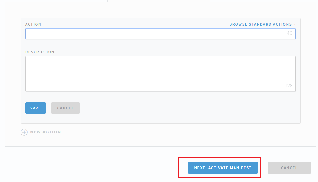

6. After creating all data field as your requirement now, click DEVICE ACTION
7. Ignore this step (no action is required for this project), just click on ACTIVE MANIFEST
8. Again click on ACTIVE MANIFEST. Be sure you have created all the necessary field. Manifest is not editable.

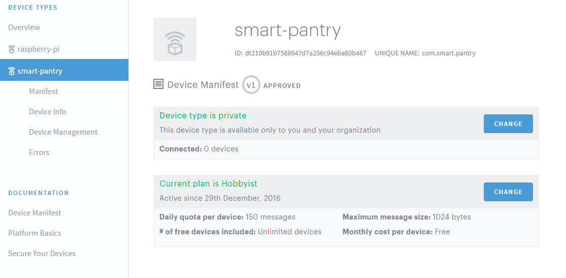

9. After activating manifest you will observe following information about your created device. You just created a new device and now you have to connect the device to your account. To connect the device follow the next steps.

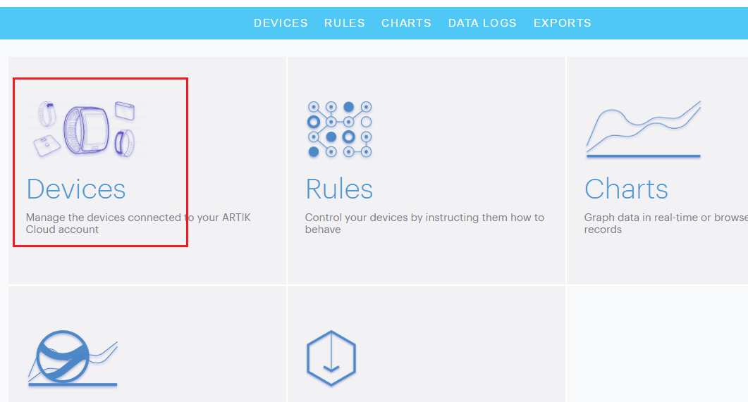

10. From your cloud account, click on Devices

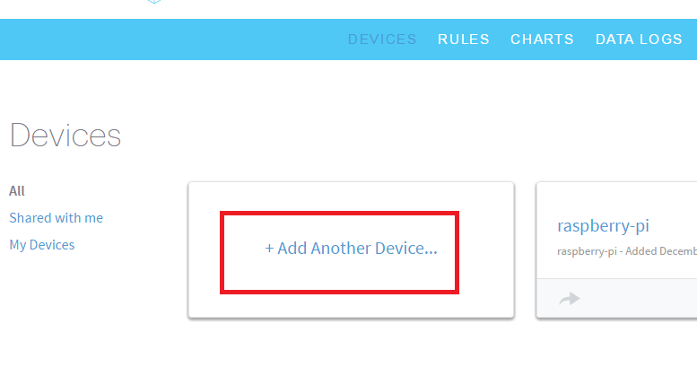

11. Click to Add Another Device. This interface may different in your case as it is the first time you are connecting a device. I already connected a deice named raspberry-pi.

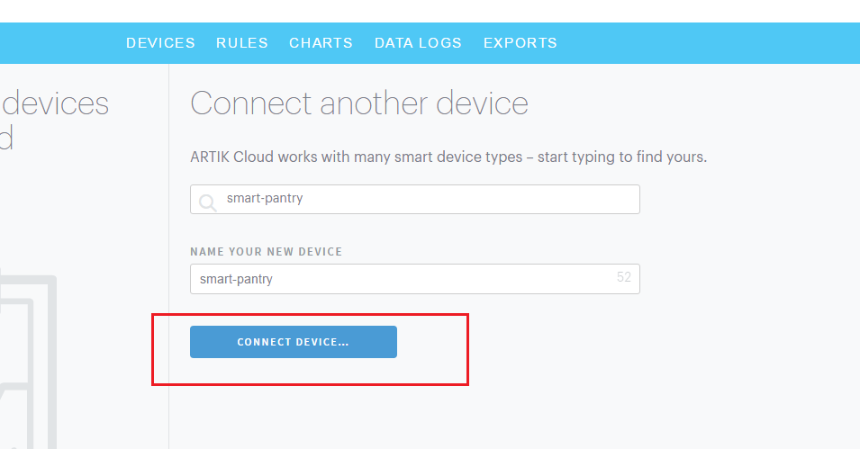

12. Type the name of your device created earlier and select your device from drop down.
13. Then click on CONNECT DEVICE

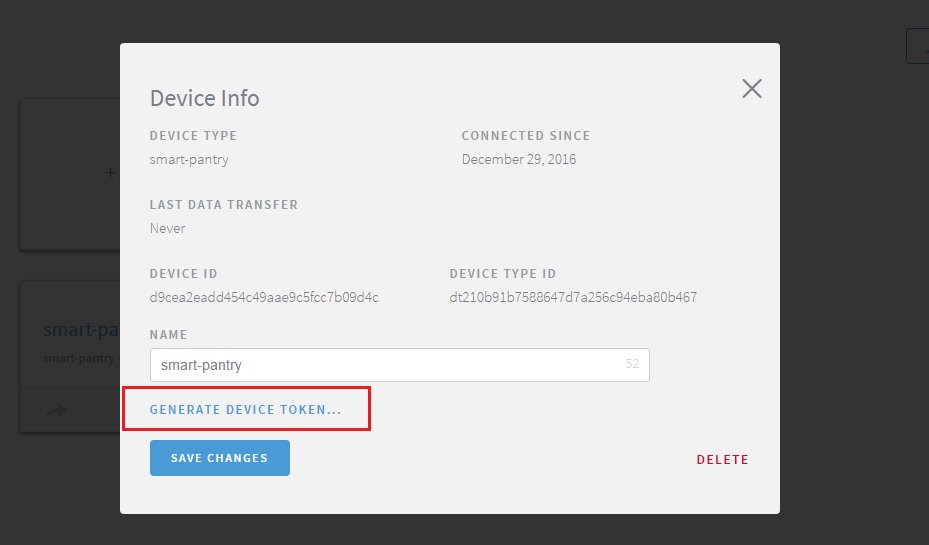

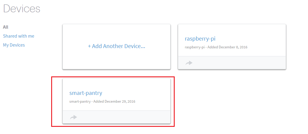

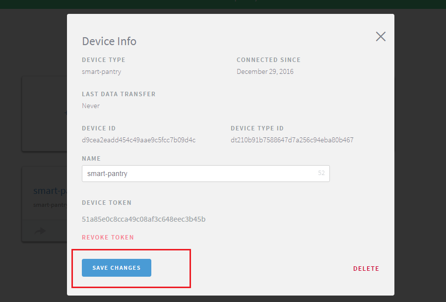

14. My device smart-pantry is now connected. Probably you are also connected like me. Click on the connected device to get device id and device token.
15. You will get following window. You device id is ready. To get device token click on GENERATE DEVICE TOKEN. Your device id and device token is very important and will be required to upload data to cloud and we will use this id in our program used in raspberry pi.
16. Click on SAVE CHANGES.
17. Congratulation!!!, Artik cloud is now ready to receive our data and we have device id and device token to access Artik cloud.

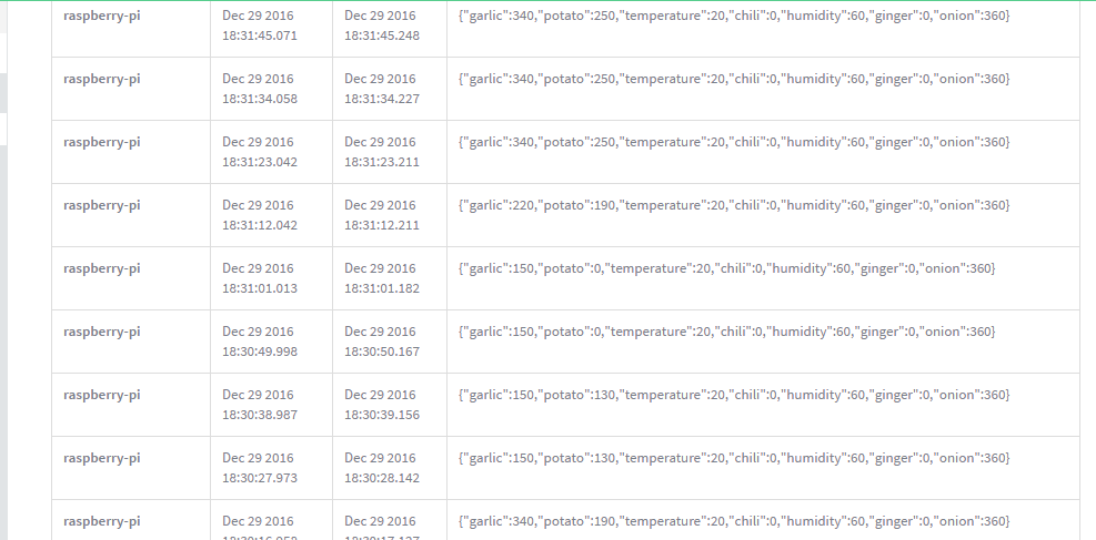

Copy the device id and device token. Replace DEVICE ID & DEVICE TOKEN in the smart-pantry.js file with your own device ID and device token you just copied from your Artik device. Now, you are ready to run the code in raspberry pi using following command.
sudo node smart-pantry.js
After successfully publishing the data to your artik device you will see your data in json format from Artik DATA LOGS menu like following.

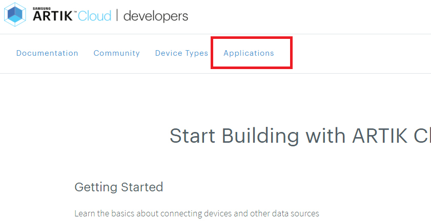

Before going to develop an Android application we will be required to create an application to Artik cloud. After creating an application we will get a client id which will be used to read data from artik cloud using Android app.So, let's create an application in artik cloud. Login to artik cloud and follow the steps below.

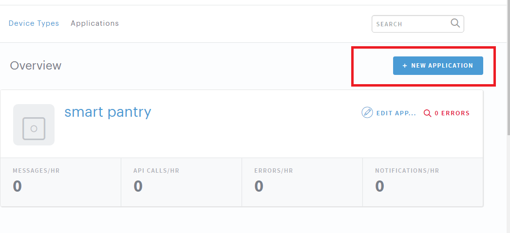

1. From the developer console select Application.

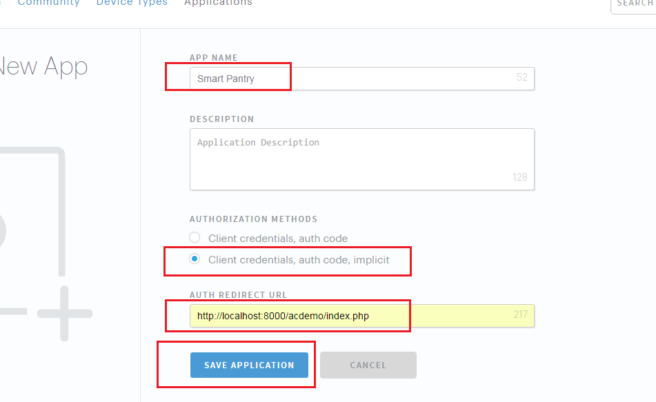

2. Click on NEW APPLICATION
3. Give an APP NAME. Description section is optional. Fill another options according as image and click to SAVE APPLICATION.

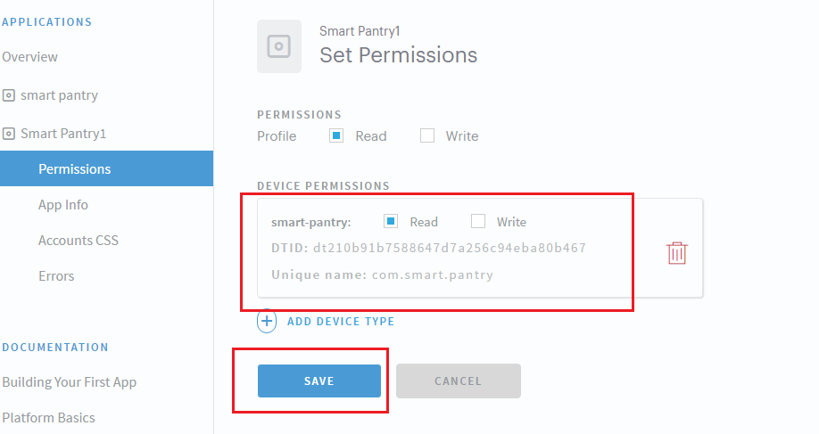

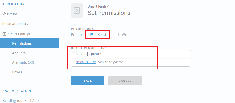

4. Select Read from PERMISSION. Type your device name into DEVICE PERMISSION box and select your device.
5. Set Read permission for your device and then click to SAVE.

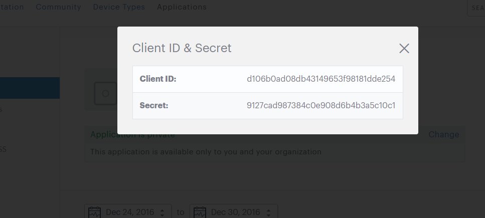

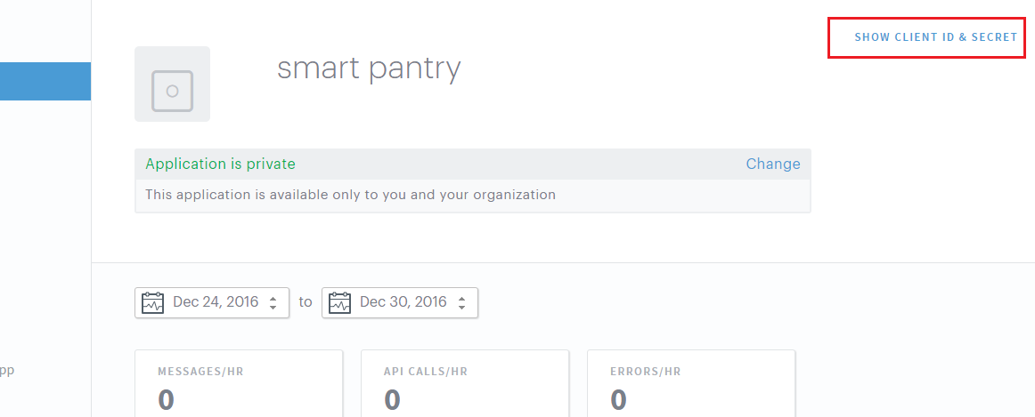

6. To get client id click on SHOW CLIENT ID & SECRET button. Client id is important and will be required at the time of android app development.
7. Note your client ID from the Client ID & Secret window.
