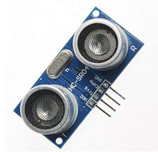

  • Ultrasonic Sensor: http://www.ebay.com/itm/2PCS-Ultrasonic-HC-SR04-Distance-Transducer-Sensor-For-Arduino-Robot-/281683048595?hash=item41959e3893:g:8v8AAOSwgkRVSKAs

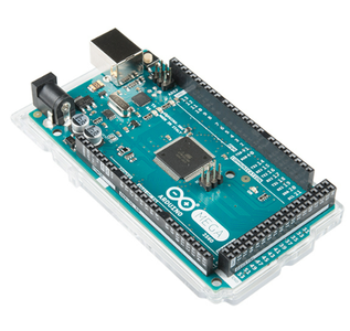

  • Arduino Mega 2560: http://www.ebay.com/itm/MEGA-2560-R3-Board-ATmega2560-16AU-CH340G-USB-Cable-for-Arduino-/272114251255

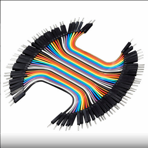

  • Jumper Wires: http://www.ebay.com/itm/40pcs-20cm-Male-to-Female-Pin-Header-Dupont-Wire-Color-Jumper-Cable-For-Arduino-/201402081637?hash=item2ee47fe165:g:EAgAAOSwjVVVw0cc

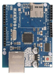

  • Arduino Ethernet Shield: http://www.ebay.com/itm/Ethernet-Shield-W5100-For-Arduino-Main-Board-2009-UNO-ATMega-328-1280-MEGA2560-/400356634583?hash=item5d371d6fd7:g:A14AAOSwSclXL-HG

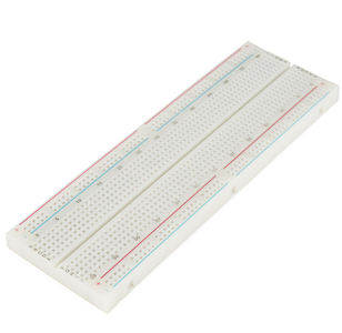

  • Breadboard: http://www.ebay.com/itm/830-Tie-Points-Solderless-PCB-Breadboard-MB102-65Pcs-Jumper-cable-wires-/231412564779?hash=item35e143832b:g:tYIAAOSwZQxW6MB7

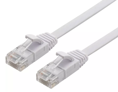

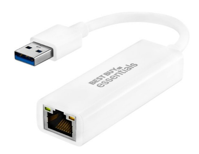

  • Ethernet Cable (and USB Adapter if needed): http://www.ebay.com/itm/25FT-CAT6-Cable-Ethernet-Lan-Network-CAT-6-RJ45-Patch-Cord-Internet-Black-NEW-/331729510954?hash=item4d3c9ea22a:g:Vx0AAOSw7ehXR3Ds

*Please be aware that breadboards are broken in half horizontally and vertically. Keep your connections on either side separate!
Connect your shield accordingly to the name of the pins. They should all line up. A0 goes to A0 on the Arduino Mega, 1 to 1, 2 to 2, etc.

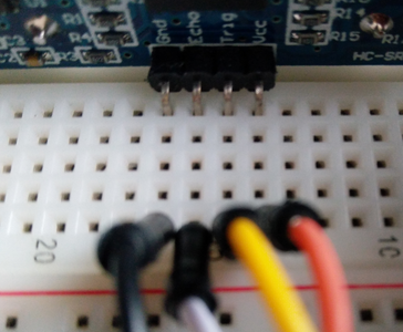

Connect the pins of the Ultrasonic Sensor (there should be 4 of them!), and put them anywhere horizontally on the breadboard. We recommend not connecting the sensor between the gap, or in any of the positive/negative rails. Since the hidden wires run the long ways of the breadboard, spacing the gap wouldn't give you the full connection to the sensor. Also, putting the sensor in the positive/negative rails keeps you from connecting more sensors, as well as the other necessary connections for the Ultrasonic Sensor.
  • Connect the VCC pin to the Positive rail on your breadboard
  • Connect the GND pin to the Negative rail on your breadboard
  • Connect the Trig pin to the 25 digital pin on the Arduino
  • Connect the Echo pin to the 26 digital pin on the Arduino
See the above picture(s) for the connections from the Arduino Mega to the Sensor on the breadboard. If you have more sensors, we recommend connecting a jumper wire from the VCC pin to the Positive (+) pin line , and the GND pin to the Negative (-) pin line. From there, connect a jumper wire from the Positive (+) rail to a 5V pin on the Arduino, and another jumper wire from the Negative (-) rail to a GND pin.

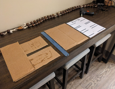

Now that we have our electronics ready, we need some way of showing what our model will actually look like in a real world environment. Since this is just a model of that real world environment, our mechanical components will be very simple. Feel free to be more creative in the area, so as to make it how you want it to look! For our purposes, we are using cardboard and paper.
Using scissors, we cut cardboard to make our base, which has dimensions of 13 inches by 7 inches. We also wanted to show how the data moved physically, so we made 2 base connections from the bottom of the base that connects a side panel to the base. This piece is 13 inches by 4.5 inches. This is all connected via hot glue. Be careful!
From there, we made a drawing of a parking lot with spaces. This was then glued to the top of the base piece.

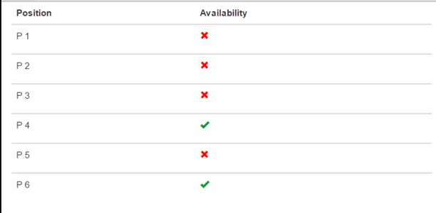

Step 8: Parking Lot Table Display
In order to show the values to the user we must select and fetch them from the database. So we can do that with PHP. Showing them to the screen is will not suffice as the user seeing the screen should understand what the program is trying to say. In order to make it decipherable, we must add a tiny bit of bootstrap into it. We will also be adding something called as a glyph-icon , it is a term in bootstrap which you can look into in more depth in this link: http://getbootstrap.com/components/
Here is the code for the display page (it is the "ParkingLotDisplay.php" file): https://drive.google.com/drive/folders/1zJ3Pd-Y82btJbZqeF074tat5c-DVXCF0?usp=drive_link
Note that your data display page should look like the one in the image. You are done! Congrats!
