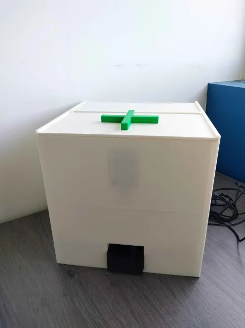

Step 3: Putting the Circuit in the Housing
Now that we 3D printed our housing we can put th circuit into the box, it should look something like in the picture above.
