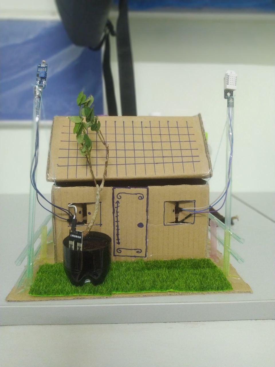

Introduction: Smart Plant Monitoring
Have ever heard about Smart Plant Monitoring using telegram ? This system can help people who are busy working to monitor their plant using mobile phones although they are far away from home. They will get some notification from the telegram on their mobile phones, about the condition of the plant such as the temperature, humidity around the plant, the presence of light and moisture of the soil. In this system, we use NodeMCU (ESP8266) as open source to link items and transport data using the Wi-Fi protocol, temperature and humidity sensor, soil moisture sensor and ldr sensor. So, if the plant in not good condition whether the temperature was too high, humidity was too low the user will get the notification from the bot in telegram.
