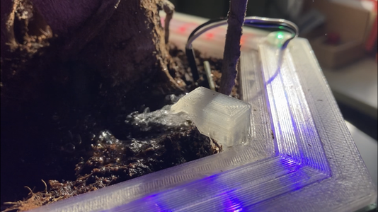

Step 2: Connect Everything
In this step I lay the cables in the housing and plug all sensors together (soil moisture sensor to IC board) Shorten and lay the pump cables (shorten all cables ...). I also fix the sensors all in place.
Step 3: Upload the Code
Den Arduino-Code auf dem Board laden
Step 4: Wire Up 1.1
Now I wire everything see: "Bread board".
Step 5: Wire Up 1.2
Additionally I solder the ws2812B led strips into the inner pot and lay the cables in the housing.
Step 6: Cut the Pipe
Cut a piece of pipe to connect the iner pot to the pump.
Step 7: Planting
Finally, just put the plant in the inner pot and fill it with water.
