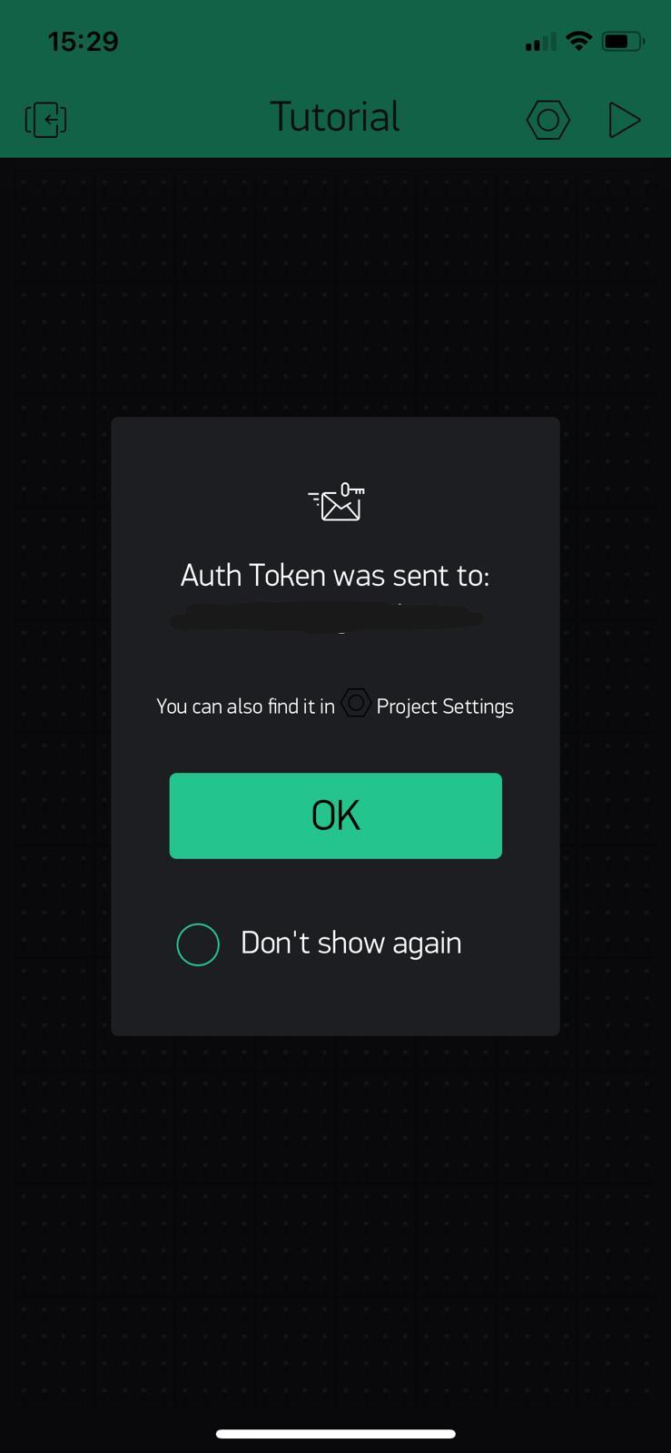

  • a token will be sent to your email - save it for later (image 3 )

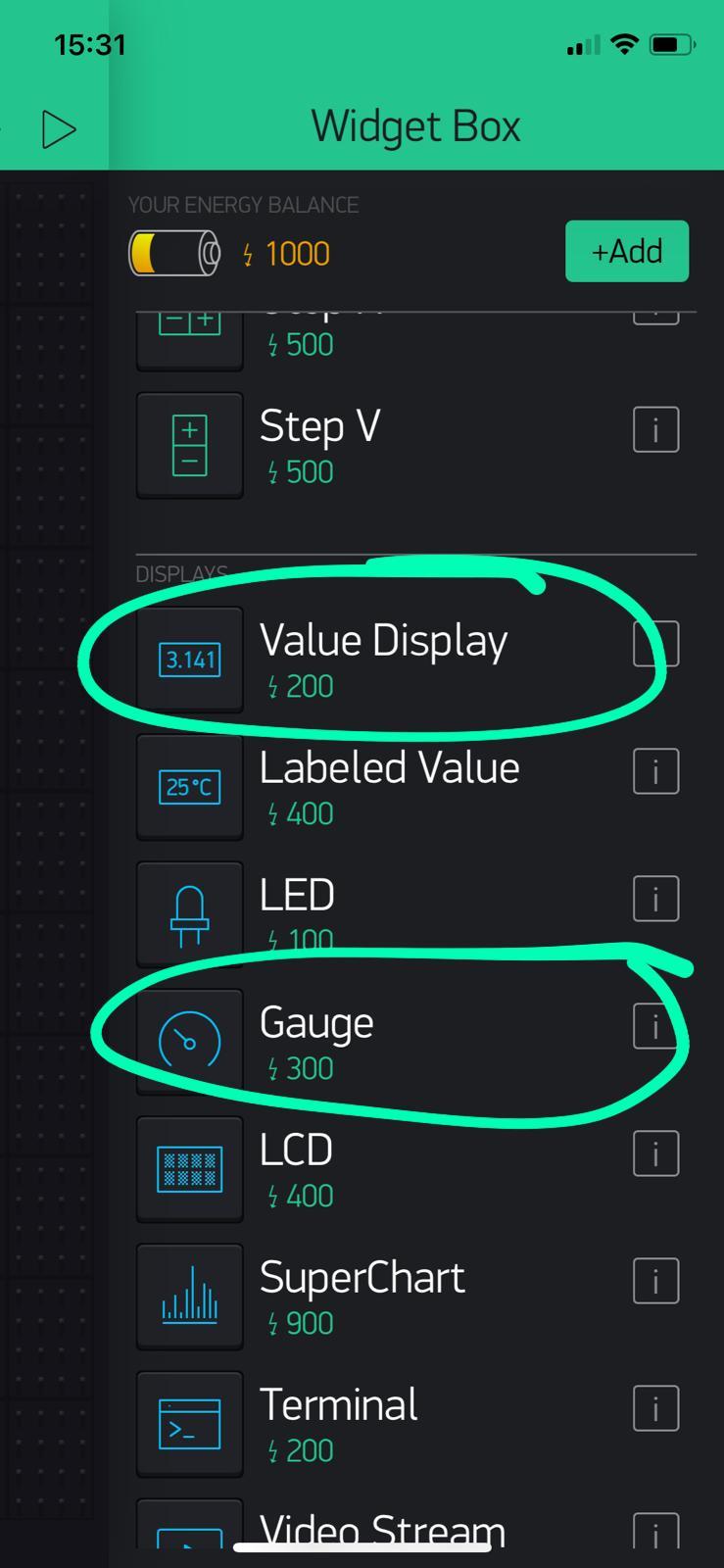

  • click on the empty app screen of your project to open the 'Widget Box'
  • add 'Value Display' and 'Gauge' (image 4)
  • add 2 'Webhook' (image 5)

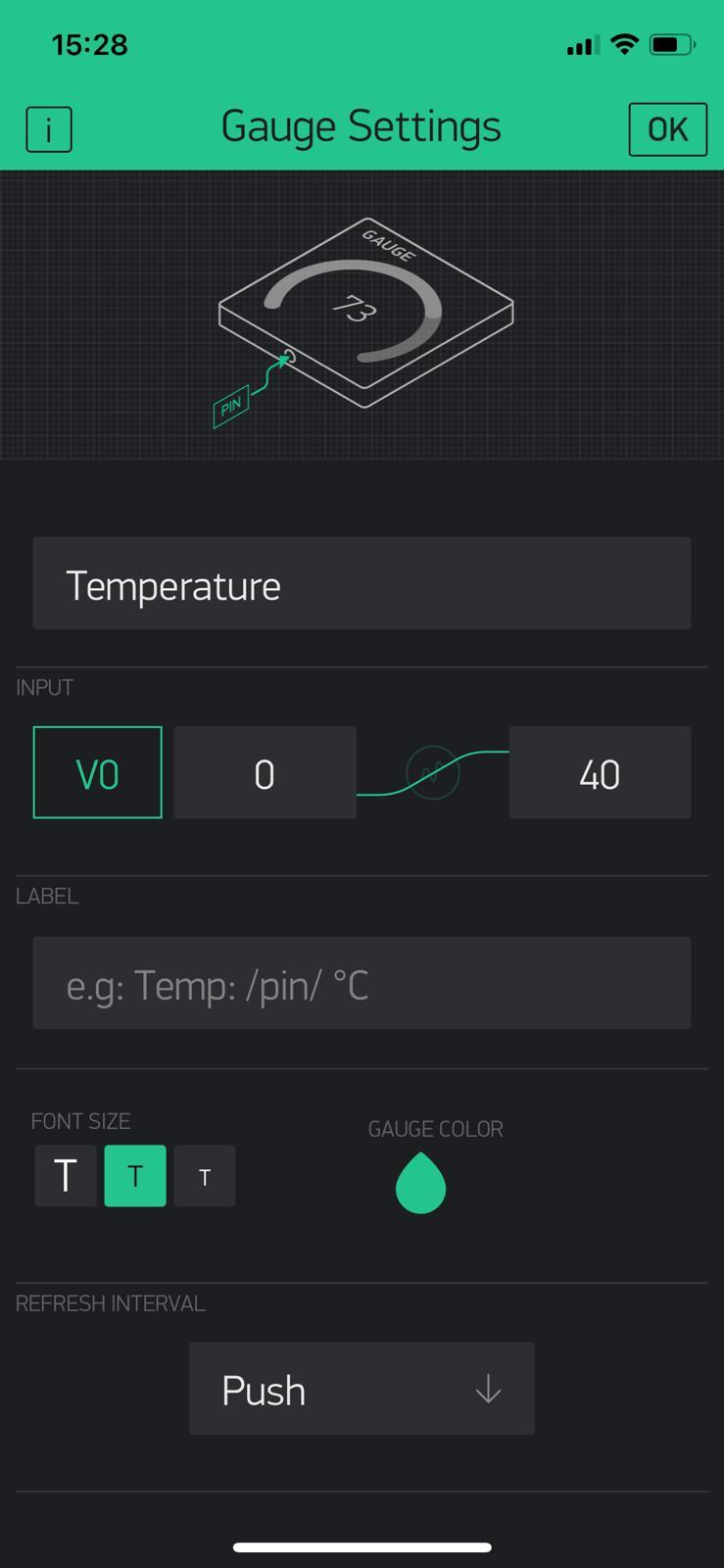

Temperature:
this is our 'Gauge' widget. choose a virtual pin (we used 'V0', it doesn't matter which one you use) and set the range from '0' to '40' (Celsius) ( see image 1)

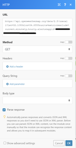

4. configure the HTTP module like shown in picture 2. replace the 'lat' , 'lon' values with the latitude and longitude values of the place you wish to get the forecast of (in this project, we want to put our city there) use latlong.net for that. replace the 'appid' value (marked in black) with the API key you saved from before.
Make sure 'parse response' is checked and run the scenario once. open the webhook address so the scenario is being played. now we have access to the forecast data and we can integrate it into our push notification!

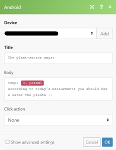

3. save the webhook URL and put it inside the URL line in your other 'webhook' widget inside of your blynk app (see step 3 picture 3). at the end of it add 2 parameters like so:
?param1=temp&param2=YN

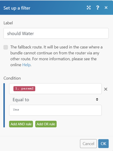

4. set the router's filter like shown in image 2 for one android module, and use the same parameter for the second filter with the condition switched to 'not equal to'.
5. configure an appropriate text for each android module (image 3 is an example of the android module connected to the filter shown in image 2) .
