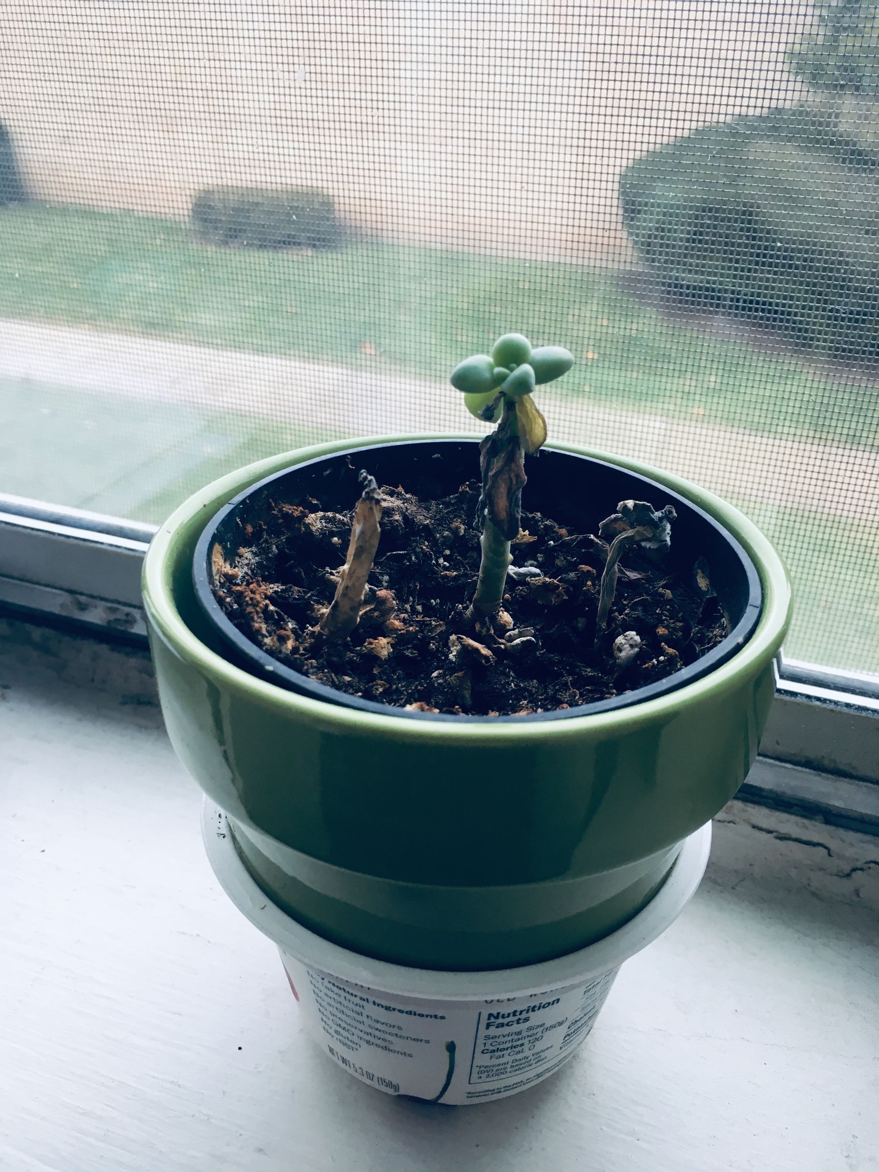

More and more people are looking into buying indoor plants, especially millennials. However, “Roughly 1/3 of all plants purchased die within a few months of being brought home”. Although one of the advantages of the indoor plants is they are low maintenance, people are still killing their plants over and over again. Unlike having an animal pet, the plants’ status and needs are not obvious to the owners and may be neglected.
Due to the reason that I always kill my plants, I try to make my own self-watering system for my plants to keep them alive. Also, the box will show you the status your pet plant. The objectives of this project are:
