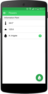

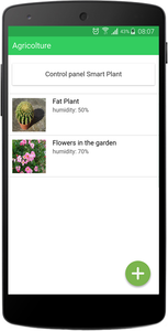

Afterwards we programmed a mobile App that permits to select the interested plant and to irrigate it how many times we prefer.
If we forget to feed our plants a notification will be sent to your phone.
If notification is ignored and the ground moisture is in a critical state (in percentage), Edison board will calculate how much of water the plant needs to "bring back to life" our plant.
Obviously, if our plant needs 1 liter of water, Edison Board will feed the plant little by little up to the calculated water needed by plant
