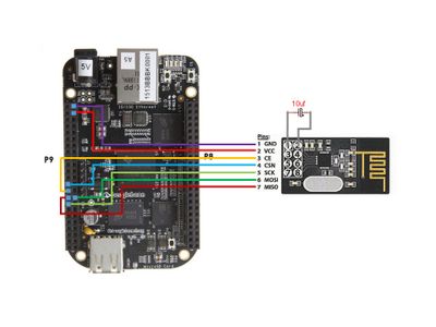

Step 3: Gateway - Hardware
Materials:
A Beaglebone Black board
A nRF24L01+ module
A 10uF capacitor (RadioShack, ebay etc.), for improving the reception reliability.
Here I show the connection between the Beaglebone Black and the radio module. I also show my circuit for it, but a breadboard will do the job as well.
To use the SPI and nRF24 module in Bealebone Black, two steps are needed.
