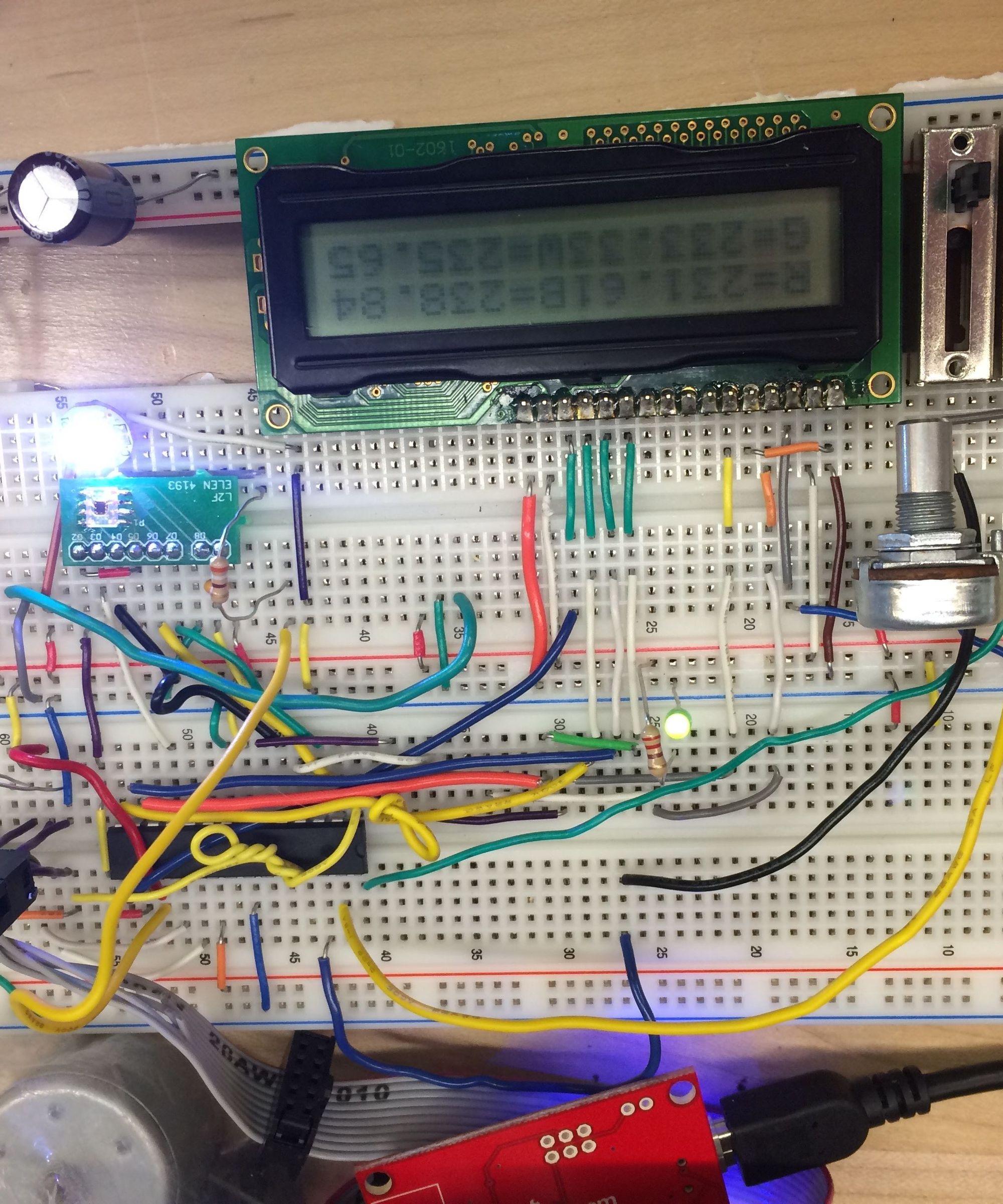

Step 7: Launch Mechanism and Electronics Setup
After further tests, I wanted to automate the process more. Instead of cutting the nylon wire with a scissor to release it, a quasi-cam motor would chop the wire instead.
Again, more over-engineering here. The quasi-cam guillotine motor does not need to have a block of wood attaching it. Instead just use wood glue on popsicle sticks and attach it to the side of the motor at the right height.
The guillotine motor is a razor blade glued between two popsicle sticks. The popsicle sticks are then attached to the motor head with wood staples.
Be sure to make sure the servo motor will move to the position where it will cut the nylon motor before continuing!
The potentiometers control the manual movement of the base and the buttons with the LCD calculate the automatic angle finder after inputting a position in cm.
Use a low value resistor to ensure that not too much current is going to arduino before connecting button output to arduino board.
See pictures to make electrical connections!
- - button to 1
- + buton to 12
- Enter button to 13
- "Guillotine" Motor to 3
- xy (bottom) motor to 9
- z (top) motor to 10
- lcd: (8, 11, 7, 6, 5, 4) - RS,EN,D4,D5,D6,
