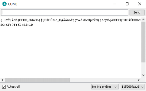

Step 15: Get the MAC Address of the Receiver Board
To get the MAC address of the board upload this code to the board.
#include <ESP8266WiFi.h>
void setup(){
  Serial.begin(115200);
  Serial.println();
  Serial.println(WiFi.macAddress());
void loop(){
Then open the serial monitor, and reboot the board.
If done correctly, you should see the MAC address in the console.
The MAC address of this board is 5C:CF:7F:FD:85:1D
