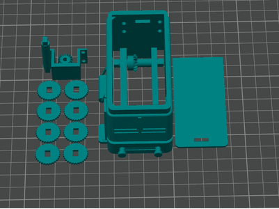

Step 1: Print the Train
I recommend using a high resolution, specifically a 0.10mm layer height, for the train, as this layer height provides good tolerances for the shaft with the bevel gear. Additionally, use tree supports for optimal printing results.
After printing, use the pliers to remove the supports carefully.

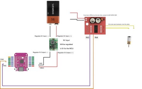

Step 2: Wire the Locomotive
Wire the components as shown in the picture.
After wiring, place the components inside the train and secure them using screws.
