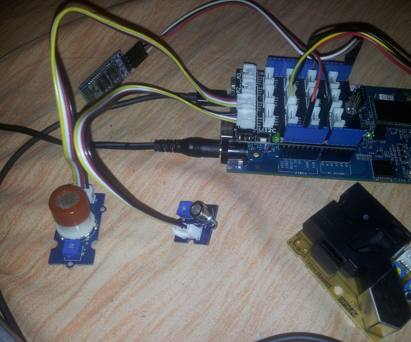

  • 2 or more station with light notification and distance sensor to detect cars passage (each build with 1 arduino + 1 ultrasonic sensor + 1 light + Xbee radio transmitter)
  • 1 master to gathering all stations notifications, coordinate actions (light on/off) and send statistic to remote server (build with 1 edison + Arduino adapter board + Xbee radio transmitter)

Step 3: Station Build
Station build
Each station is composed by:
⦁ 1 Arduino
⦁ 1 ultrasonic sensor
⦁ 1 relay (to connect to light)
⦁ 1 Xbee module (configured as router see previous step)
The connection between Arduino pins and modules are follow: Ultrasonic sensor:
⦁ 5V --> 5V Arduino
⦁ GND --> GND Arduino
⦁ Echo --> digital pin 2 Arduino
⦁ Trig --> digital pin 3 Arduino
Xbee radio module:
⦁ 5V --> 5V Arduino
⦁ DOUT --> digital pin 4 Arduino
⦁ DIN --> digital pin 5 Arduino
Light relay:
⦁ Command --> digital pin 6 Arduino
After make all connection, the Arduino should programmed. Here the sketch to use:

Step 4: Master Build
Master build
Each master is composed by:
⦁ 1 Edison + Arduino adapter board
⦁ 1 Xbee module (configured as coordinator --> see previous step)
The connection between Arduino pins and Xbee radio module are:
⦁ 5V --> 5V Arduino
⦁ DOUT --> digital pin 0 Arduino
⦁ DIN --> digital pin 1 Arduino
The master shall program with a project created with Eclipse editor. In the head of program is possible to configure the lookup table with actions to do after any notification from stations.
Using integrated wifi on the module it’s possible to connect the board to Internet and send remote statistic.
