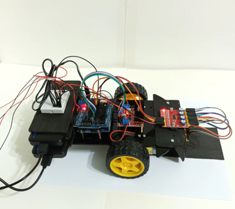

The Smart Robot Car Kit has already served as the basis for some blog posts. I had in this Post modified a toy car and equipped the Robot Car with sensors. With the front ultrasonic sensor, he can recognize obstacles and avoid them By changing its direction of movement. Since the car is modular, it offers us options for modification. In this project we will add a four -fold line, so that it follows one black line painted on the floor. To do this, a four infrared sensors are added and a new sketch is programmed.
The black color of the line absorbs the light, the white color reflects. The reflected proportion is detected By the sensor. These properties are used to follow the line. The sketch then only has to be programmed so that the Robot Car drives along the line.
Step 1: Circuit and Description of the Modules Used
Download the circuit
We use a microcontroller, a Sensor Shield module, to connect the components and modules and with the AZ-L298N controller module, we control the speed and the direction of rotation of the engines. All of these components are included in the Smart Robot Car Kit. To follow the line, a 4-channel infrared sensor module is added. The necessary voltage to supply the infrared module must be 5V, while the supply voltage of the microcontroller and the AZ-L298N module is 10 V. As you can see in the circuit, I use two 5-volt battery packs and switch them into series. So I get the 10 VDC (red line) for the power supply of the microcontroller and the AZ-L298N module and the 5 VDC for the infrared form module (green line).
Step 2: Setting the Infrared Sensor
I modified the Robot Car from Balsa wood so that the battery packs can be accommodated. I also built a bracket to attach the sensor module. It is attached to a height of 10 mm above the ground. The maximum distance where it works satisfactorily is 15 mm.
After we have assembled all modules and components of the Smart Robot Car, we first have to set the detection of the color change from black to white. To do this, we position the Smart Robot Car on a black line that is supposed to follow it and load the sketch sensor_adjust.ino on the microcontroller. The engines are not controlled. We use this sketch to read the sensors and display the status in the serial monitor. For the adjustment we take the following steps:
  1. We place the Smart Robot Car with the four sensors on the black line. Each sensor must display a high value on the serial monitor and the LEDs D1, D2, D3 and D4 on the sensor module must be off. We use the potentiometers R9, R10, R11 and R12 to set the sensor values ​​until the LEDs on the board are off.
  2. We move the car on the side until the first set of transmitter and recipient sensors comes out of the black area of ​​the line. At this moment, the measurement value in the serial monitor of this sensor should be low and light up the corresponding LED of the adjustment module. If the measured value does not change and the LED does not go out, we set the corresponding potentiometer until the value changes. To make sure we repeat this step.
  3. The other three sensors are set in the same way. This should be recognized that the Robot Car leaves the line.
As you can see, it works in this case that all sensors are completely over a black line. Alternatively, it could also be programmed in such a way that the inner sensors stand above a thinner line and the outer sensors outside the line.
