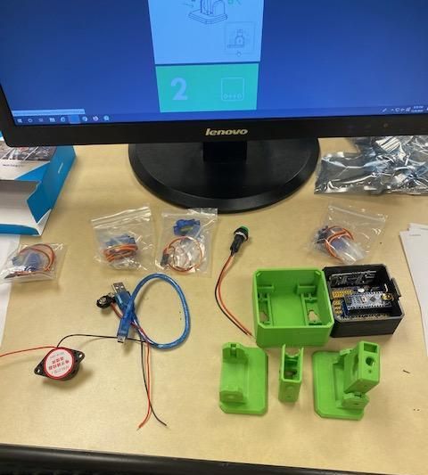

Gather all your equipment along with your instruction manual. You should have:
4 DC motors
2 Acrylic chassis
M3 nuts
Aluminum blocks
Hexagon socket screws
1 L298N
Separation shims
Line tracking module
IO expansion board
R3 Board
Bluetooth module
Ultrasonic sensor module
2P, 4P, 5P, and 6P cables
4 Tires
