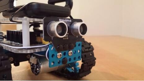

Step 4: Reconfigure the Hardware
1. Remove the battery box and strap it below the robot using two of the cable ties.
2. Take off the ultra sonic sensor and it's metal plate, then re-attach them in the lower position shown.
3. Attach the ultra-sonic range sensor to port 4 on the controller board.

Step 6: Program the MakeBlock Orion
1. Install the Arduino IDE
2. Install the MakeBlock Arduino libraries:
3. Connect the robot controller board to your computer using a standard micro USB cable.
4. Select "Arduino Uno" as the board type from the 'Tools' menu.
5. Create the following new sketch (i.e. program):-
