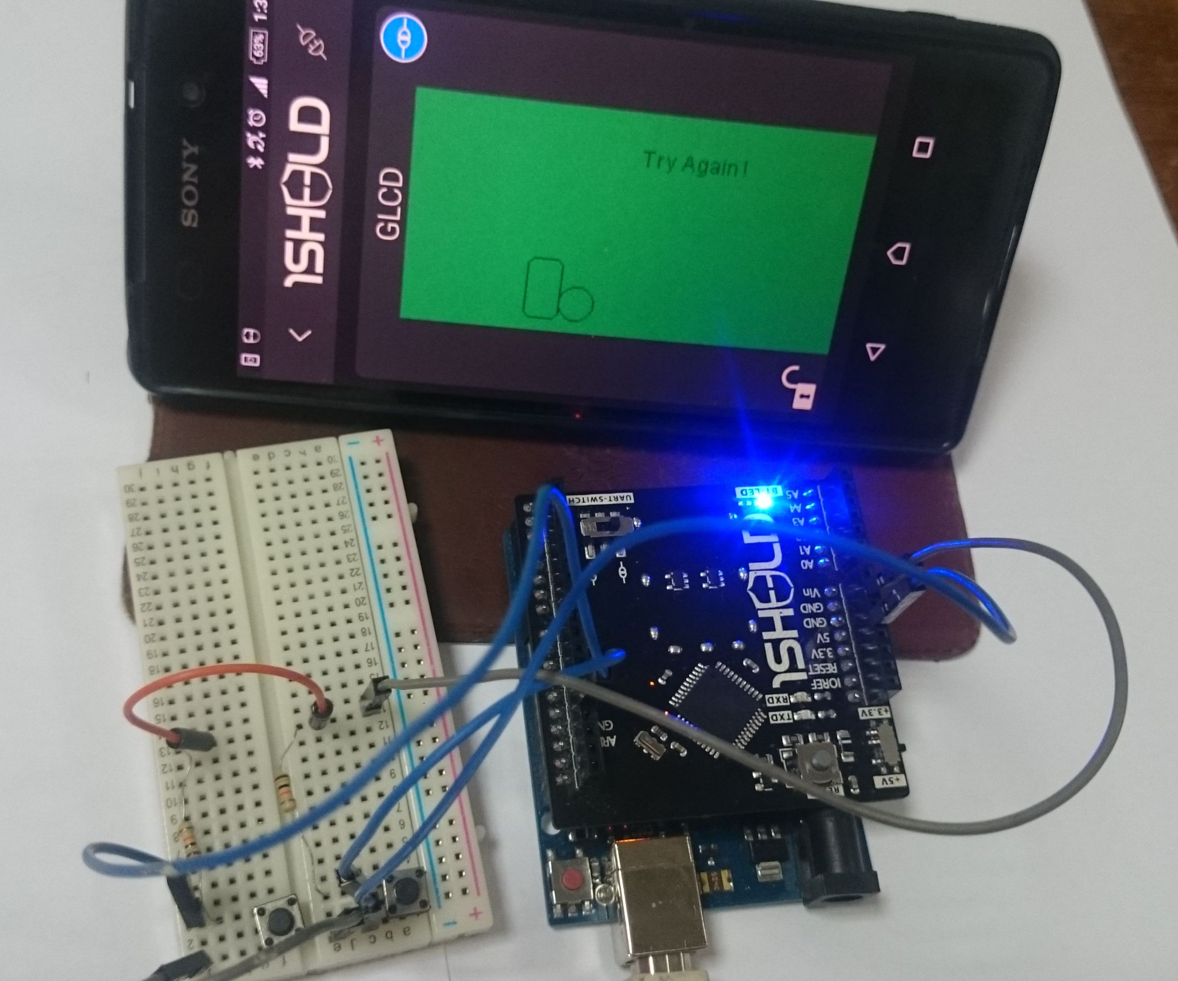

Step 2: Hardware Connections.
- Attach the 1Sheeld on the Arduino.
- Start wiring and connecting the Ultrasonic sensors to the pins shown in the schematic.
each ultrasonic sensor has 4 pins, we connect those to female-male female terminal jumper wires and then use the other male terminal to connect onto the breadboard and 1Sheeld pin.
The first pin is connected to VCC (5 volts), the two in the middle are connected to arduino pins i picked the pins in the schematic because i used them in my code of course, the last one is to GND (ground).

Step 4: Attach the Electronics to You Shoe and Test It!
1-Remove the Arduino USB cable after uploading the code.
2-Set the 1Sheeld to communication mode.
3-Using the Nylon cable ties or whatever other mean you think is more suitable for your shoe, attach the components onto it.
4-Plug the 9V Battery to your arduino.
5-Connect to your project through the 1Sheeld mobile application, you can download it here.
6-Pick the Text To Speech shield (And the Terminal Shield if you want to check as written in the code comments).
7-Now walk in the room and test it !
