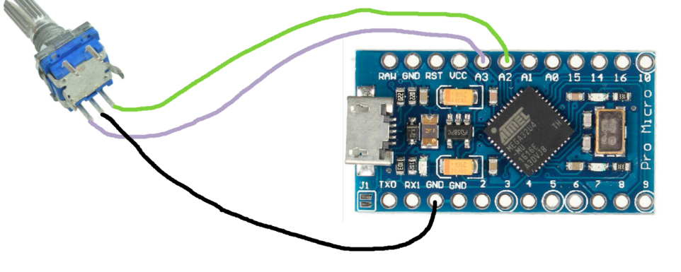

Interfacing of rotary encoder:
CLK→ D2
DT→ D1
SW→ D5
GND→ Gnd
+ → 5v
Rotary encoder is used to count the number of skips. This rotary encoder is also known as quadrature encoder or relative rotary encoder and its output is a series of square wave pulses.
Before soldering, insert encoder_knob part in the rotary encoder and insert M4 Nut in it as shown in the image.
Test all the parts before soldering. Solder all the components as shown in the circuit diagram. Use the main handle while soldering so you will get a fair idea of wire length and component placing. Use the pictures as a reference.
