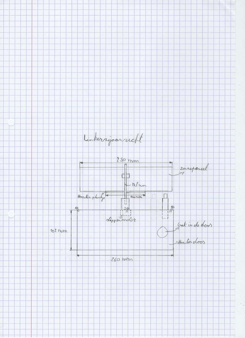

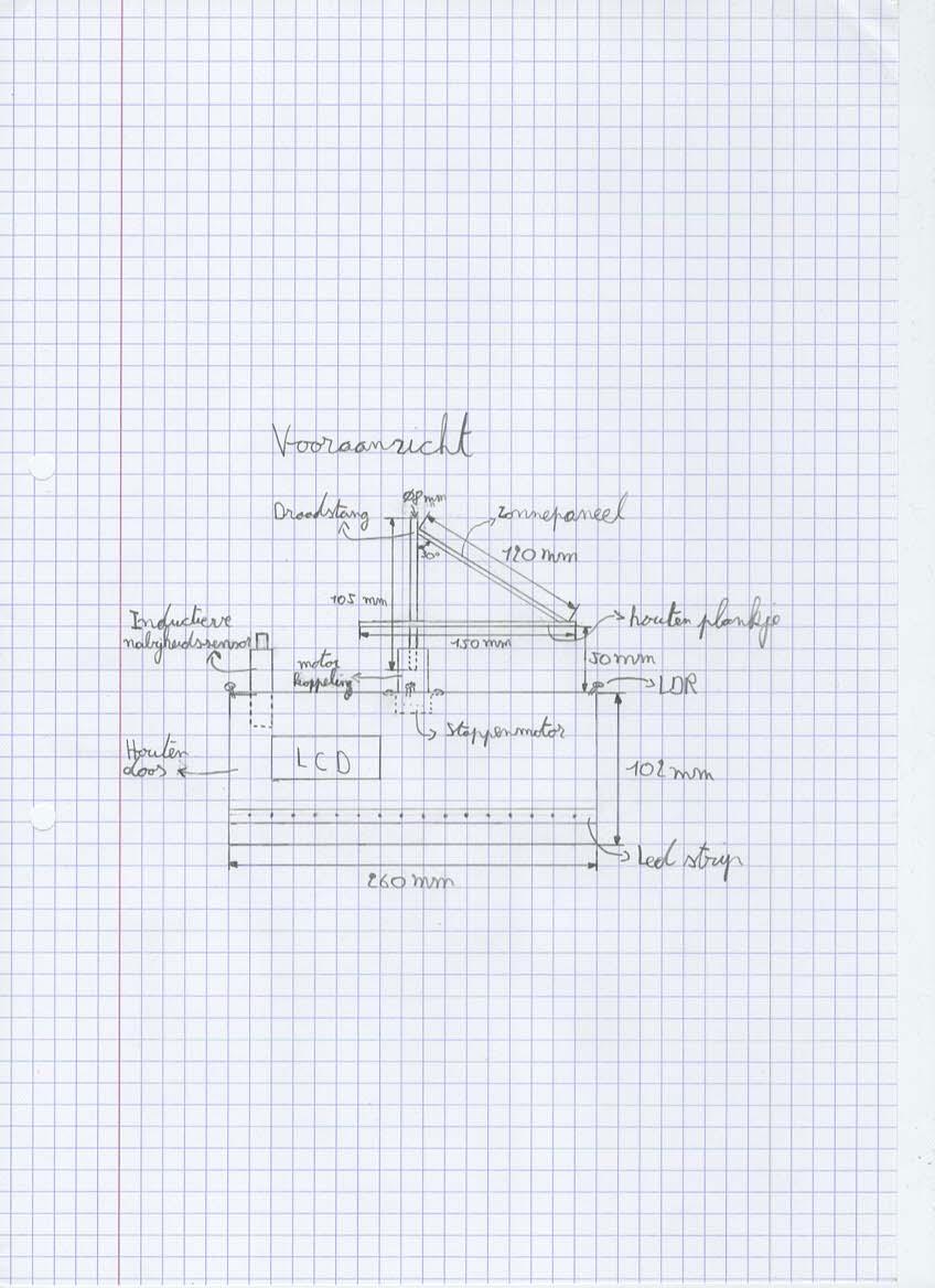

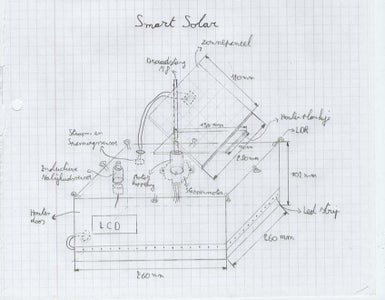

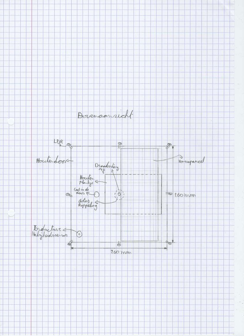

Step 4: Constructing the Housing
Above is the technical drawing of my enclosure.
Step 5: Photos of the Enclosure
I took a photo of each step, follow them in order. The measurements can be found in the technical drawing above.
