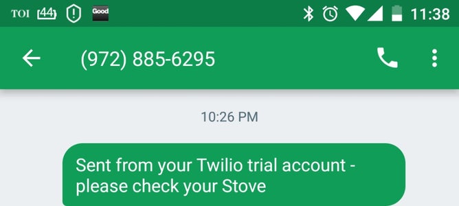

- Once the temperature reaches threshold(ex. 100 Celsius) triggers motion Circuit
- once the circuit doesnt sense any motion with in scheduled time limit, it triggers message through twilio
- Configure the residents phone number after creating a trail account in Twilio in node.

when ever the temperature reaches the threshold motion circuit gets activated and with in the scheduled time. If the Circuit doesnt sense any motions it triggers a notification through Twilio.
