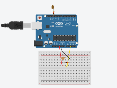

Step 2: Circuit Diagram Overview
  1. LDR Voltage Divider: LDR and 10K resistor will form a voltage divider to feed analog input to Arduino.
  2. LED Control: Arduino controls the LED through digital output pin 13.
Step 3: Build the Circuit
  1. Place the LDR on Breadboard.
  2. Connect one end of the LDR to 5V on the Arduino.
  3. Connect the other end of the LDR to Analog Pin A2 and to one end of 10K Ohm resistor.
  4. Connect the other end of the resistor to GND.
  5. Connect the anode (long leg) of the LED to Digital Pin 13 of the Arduino.
  6. Connect the cathode (short leg) to GND (you can use a 220-ohm resistor in series to limit current).
  7. Use jumper wires to make all necessary connections on the breadboard.
