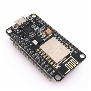

  • ESP8266 NodeMCU - 1

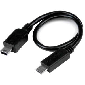

  • Micro USB cable - 1

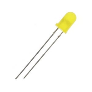

  • LEDs -3

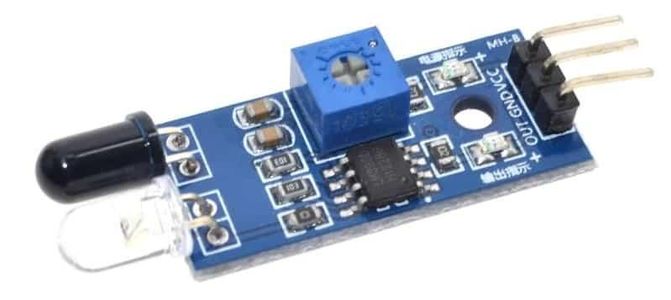

  • IR sensors - 3

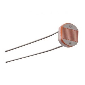

  • LDR sensors -1

To connect the sensor, there are 3 leads. One end of the LDR sensor is connected to VIN and other end is connected to fixed resistance which is further connected to ground. NodeMCU has one ADC pin (A0) which is connected to point between fixed resistance and one end of the LDR sensor as shown in the circuit diagram. Since the LDR sensor gives variable resistance therefore variable voltage will be generated at A0 according to the amount of light falling on LDR. While, IR sensor has 3 pins, two of which are VCC and ground and one is output pin. The VCC end is connected to VIN pin, while ground end connected to GND pin output pin is connected to D0, D1 and D2 pin for three IR sensor respectively. The output of IR sensor gets high if detects presence of some object. This pin is connected to GPIO pin of NodeMCU so whenever the IR sensor detects someone passing through the street it triggers the Street light. In our case one LED will be turned on. Furthurmore, the led has 3 pins, this 3 led connected to D7, D6 and D5 pins respectively.

Connect the LDR sensor to pins on Nodemcu ESP8266.
1. Connect a jumper wire from any one of the end to NodeMCU VIN pin
2. Connect a jumper wire from another end to NodeMCU A0 pin
2. Connect a resistor to the NodeMCU GND

Connect the IR sensor to pins on Nodemcu ESP8266.
1. Connect a jumper wire from VCC to NodeMCU VIN pin
2. Connect a jumper wire from GND to NodeMCU GND pin
3. Connect a jumper wire from Output to one of the pin which is D0, D1 and D2 for IR sensors respectively

Connect the LED to pins on NodeMCU ESP8266.
1. Connect a jumper wire from anode end to one of the pin which is D7, D6 and D5 for leds respectively
2. Connect another end of leds to negative line same with the GND line
