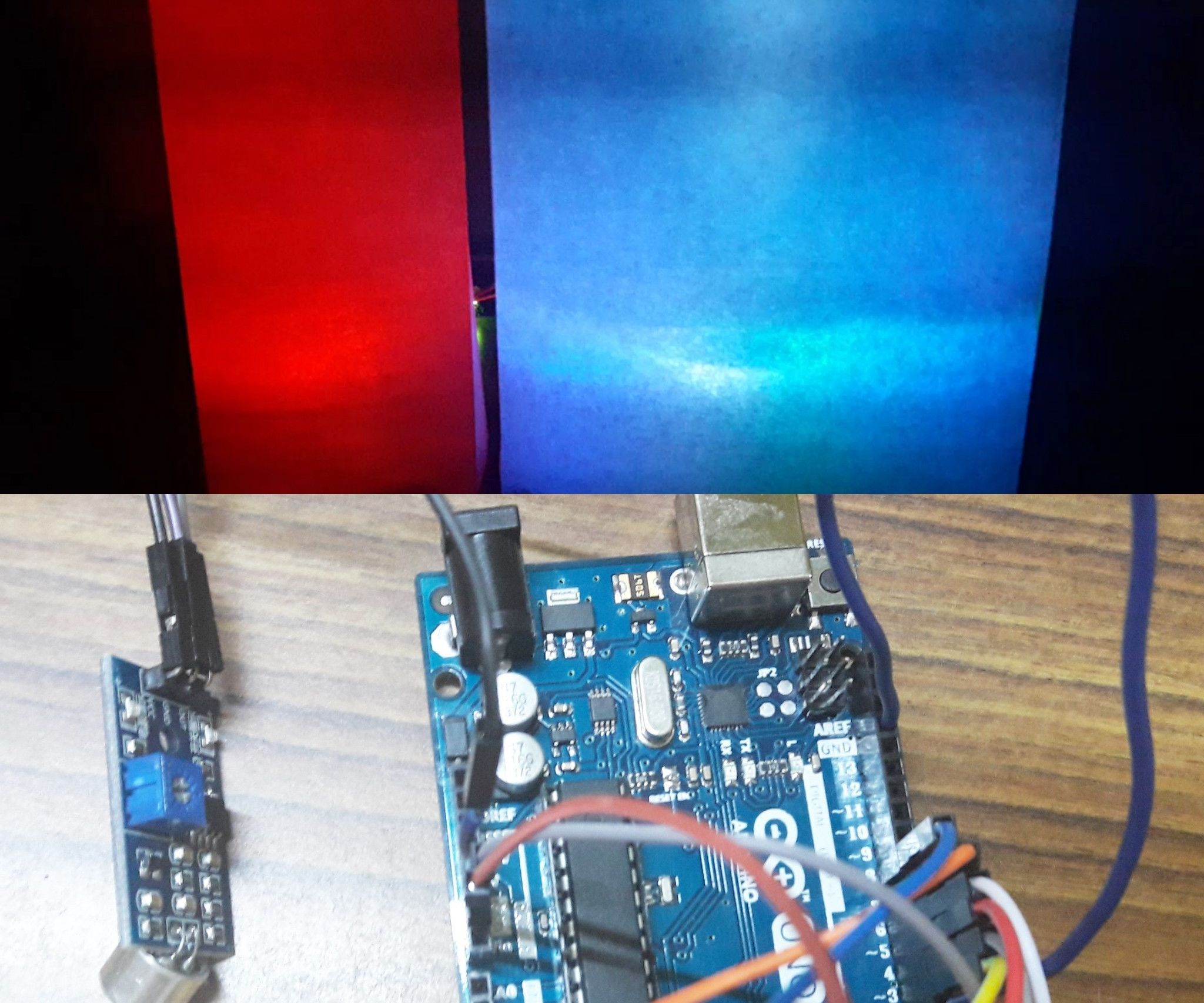

Adjust the proximity sensor at a suitable distance from the switch.
You could place the proximity sensor either above or below the switch, but alter the code accordingly. Here, I have places the proximity sensor above the switch.
Step 3: Make the Following Connections
- Vcc pin of the proximity sensor to Vcc pin on BOLT IOT
- Ground pin of the proximity sensor to ground pin on BOLT IOT
- Output pin of the proximity sensor to any digital pin on BOLT IOT
(Here, I have connected the output pin of the proximity sensor to pin 1 on BOLT IOT) - An LED is connected at pin 5 on BOLT to verify the working.
Step 4:
Upload the code onto BOLT IOT.
Step 5:
Verify the working of the prototype model by turning ON and turning OFF the switch and checking the output on the webpage.
